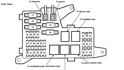

Can you tell us which fuse # it is based on this diagram.
Attached Thumbnails 92 Accord Blowing 15A fuse Taillights/Dash lights out-fuses.jpg
Old Aug 18, 2010 | 08:31 PM
spinplate1's Avatar
Joined: Aug 2010
Posts: 10
I think its #26 Its labeled "Small Light"

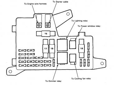

I think I posted the wrong one. How about this one:
Old Aug 18, 2010 | 11:14 PM
spinplate1's Avatar
Joined: Aug 2010
Posts: 10
lol thanks! Its definitely 23
