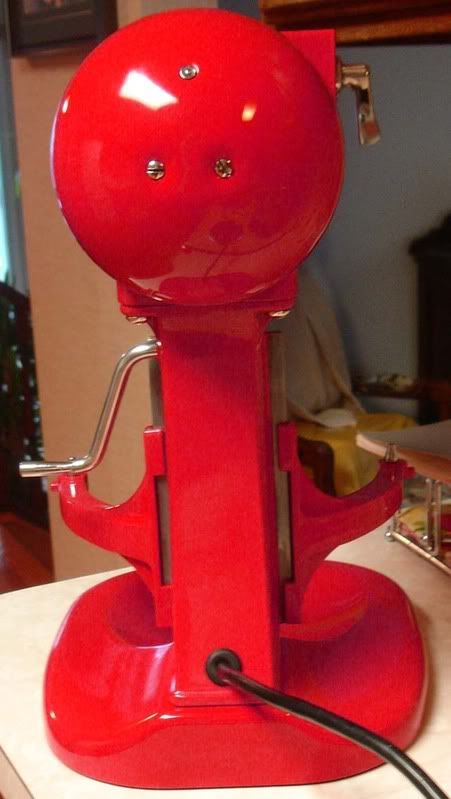

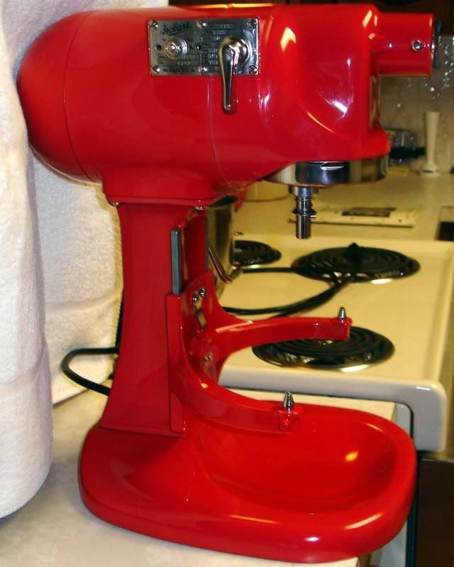

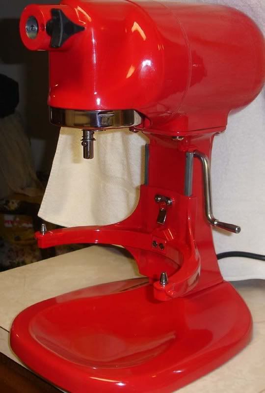

The mixer is done - looking and running fantastic.  I don''t know if I mentioned it before, but this mixer was manufactured in about 1956.  The same model is still being manufactured by Hobart and the vast majority of parts are the same as they''ve always been.
Here''s a "before":
And here are a few "afters":
