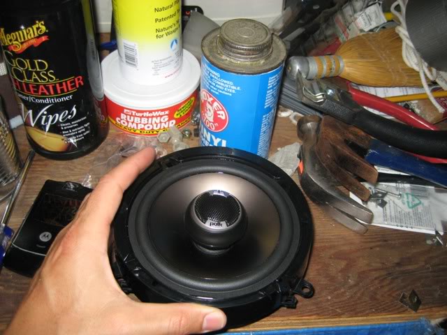

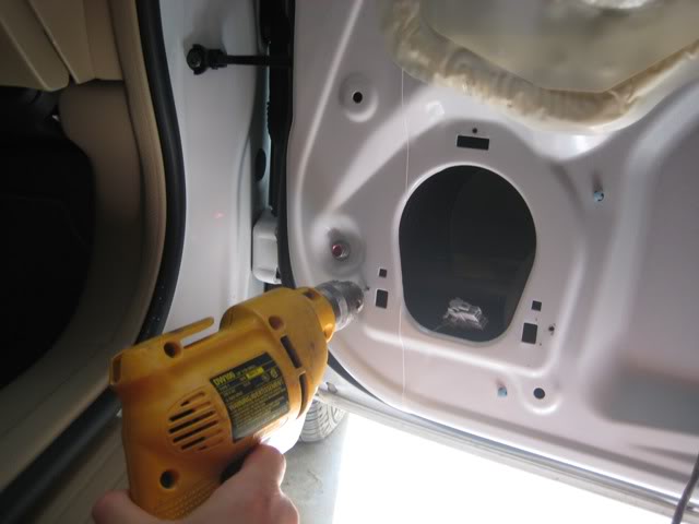

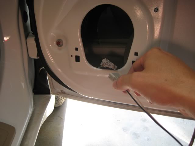

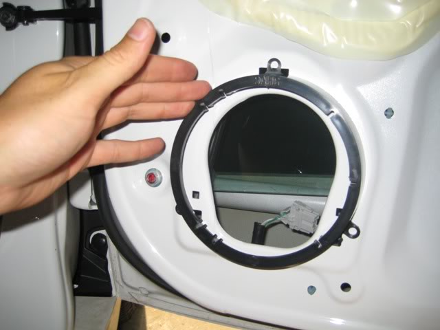

i used a mounting spacer and mounted it directly into the door.
here is a shot of the hole in the door with my speaker adapter

here is the spacer resting in the hole...lining up holes for drilling

5.25" speaker mounted in spacer on bench

drilling the holes...

then i jsut screwed it right in...apparently i didnt take a photo of that...hope this helps.

Yeah, thanks a lot for the pics. I'll definitely take that strategy into consideration, not like i'm gonna have too many other options, lol. I'm surprised the speaker holes in the doors are that small in the 07', they're probly about an inch wider in the 95'.

the stock speaker is a very shallow 6.5 that really kind of lays across the hole. that's how they got away with such a small one...
