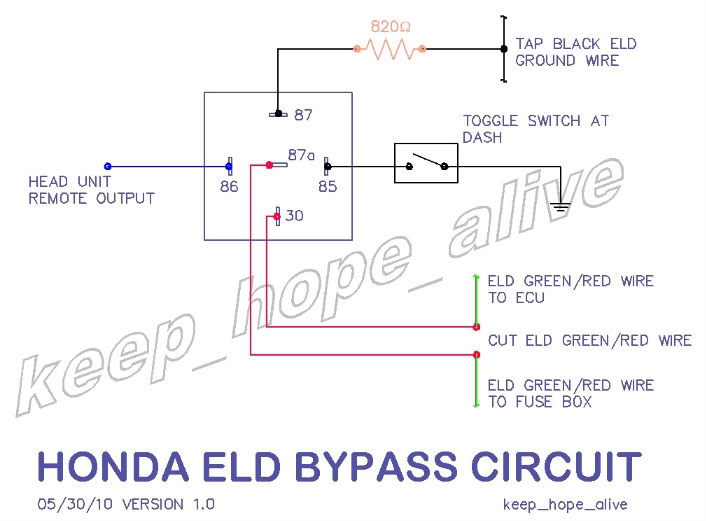

Wiring Schematic:
Attachment 20299
* It is important that Relay Terminal 30 is connected to the PCM/ECU side of the Green/Red wire cut. This corresponds to the blue wire in the relay socket.
* The normally closed (N.C.) position Relay Terminal 87a is connected to the ELD side of the Green/Red wire cut. This corresponds to the Red wire of the relay socket.
* The normally open (N.O.) position Relay Terminal 87 has an 820 ohm resistor on it that is in series with the tap of the Black ELD wire. This corresponds to the Yellow wire of the relay socket.
* The relay coil terminal 86 is wired to the head unit remote turn-on output (12VDC) This corresponds to the white wire of the relay socket.
* The relay coil terminal 85 is wired to the toggle switch. This corresponds to the Black wire of the relay socket.
* The other terminal on the toggle switch is tied to chassis ground – I used the head unit ground.

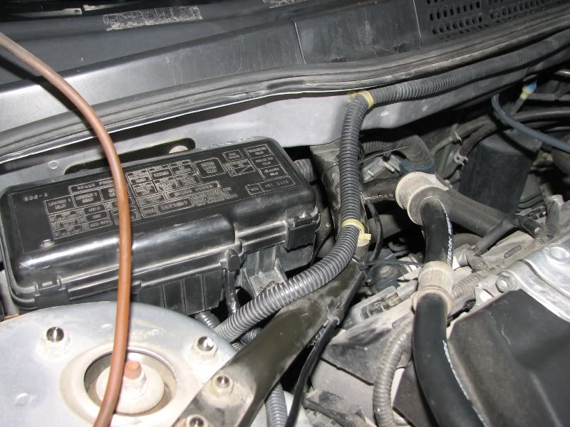

In the engine bay:
Green/Red ELD wire cut. Wires on either side - Green into the PCM and Red into the ELD. Black tapped to Black ELD ground (Not Chassis Ground).
Wires soldered, heat shrunk and taped:
Attachment 20290
Taped entire assembly:
Attachment 20291
Plugged back into the ELD and routed in the same place. You could make your taps lower and save some hassle with the cover:
Attachment 20292
Fuse box cover on, new wiring routed in 1/2" high heat split loom, zip tied to strut tower bar and routed along fire wall:
Attachment 20293

I've had the same symptoms and problems with my '99 Accord, and I'd like to install a simple manual bypass switch. I don't have a monster sound system, but I'd like to have control over the alternator, just the same.
If I interpret your diagram correctly, a simple SPDT toggle switch would work if wired like this:
1. Cut ELD green/red wire as in your circuit.
2. The half of that wire coming from the PCM goes to the POLE of the toggle switch.
3. The other half goes to one of the THROWS of the switch; the POLE would be switched to this THROW when I want to ELD to work normally.
4. The other THROW goes through an 820-ohm resistor to the black ELD ground wire at the plug; switching to this THROW would bypass the ELD and cause the alternator to turn on and charge the battery all the time.
QUESTIONS:
1. Am I correct above?
2. Are there any problems lengthening the green/red wire between the PCM and the ELD?
Thanks for an excellent idea.
keep_hope_alive 03-07-2011 06:53 PM
Yes your idea would work and not include head unit remote output.
820 ohm worked for me, should be universal, but measure voltage just to ensure you get sufficient drop. A volt meter in the car is a good idea.
