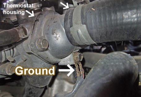

Hope the starting issue is a simple fix.....working in that area of the car, I'd re-check the ground on the t-stat housing....it is the main ground for the ECU so if it is not on/loose it will cause all kinds of issues.

Another update here: so I mentioned the thermostat housing ground to the mechanic and he said he would look into it. So sure enough he said the ground is not there. So he's going to go back through and attach the ground. Here's to hoping that's the problem. Thanks for pointing that out poorman.

He said he's going to test the distributor some more. He fixed the thermostat housing ground and that didn't fix it. I don't believe there are any codes but I personally haven't checked. I'll have to go up there and do that myself.
