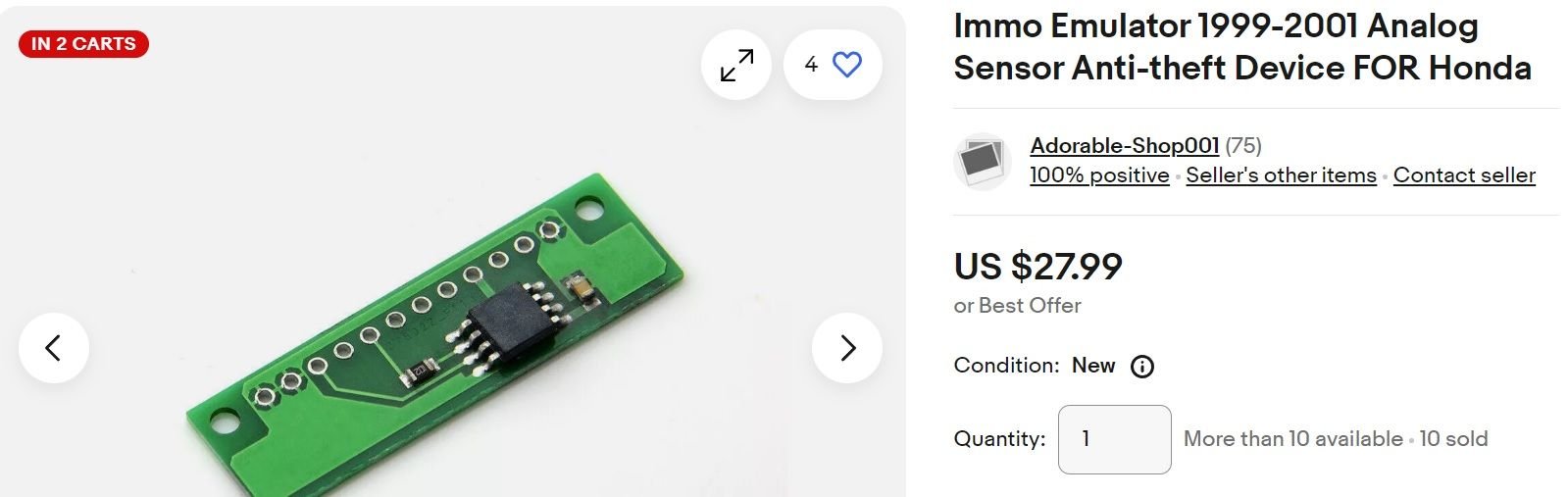

The way I did it was to rock the chip back and forth on the board until the legs broke off. The non intrusive way would be to desolder the chip and remove it that way. Nowadays they make emulator chips you can get for really cheap on ebay that you can solder in that will allow you to retain your obd code reading ability and keep you CEL from staying on. Below is pictures of the stock chip I removed and the emulator chips you can replace it with on Ebay or Ali if you can solder.

https://cimg6.ibsrv.net/gimg/www.hon...a5bbfca04d.jpg
Emus on Ebay
