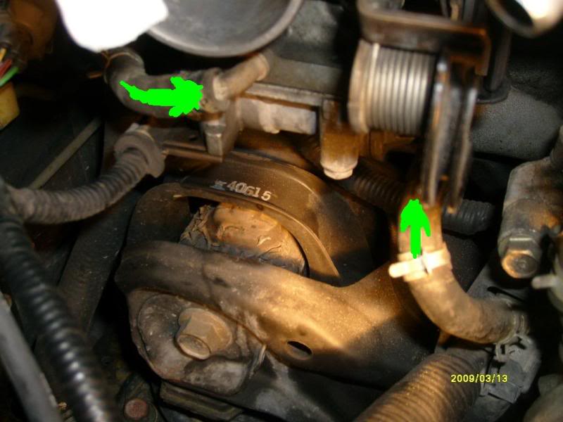

hey guys...need some advice on how to remove the coolant hose in the TB for my 94 accord ex...
its kinda stuck...is there something that i guess i could spray to make it slide off better? please advice.
i attached a pic...thanks..
Attachment 21612
PAhonda 03-13-2009 08:11 PM
Work some WD-40 in there. Try twisting the hose to work the WD-40 in there. You can also take a large screwdriver and try to push the hose off.
ford 03-13-2009 08:22 PM
thanks PAhonda..i was already thinking of doing that but just hesitating cuz i dont know if ill damage something by doing that...anyway ill try that..
ford 03-13-2009 09:22 PM
I got it out...some lube and still had to put some force but I got it...thanks!!!
