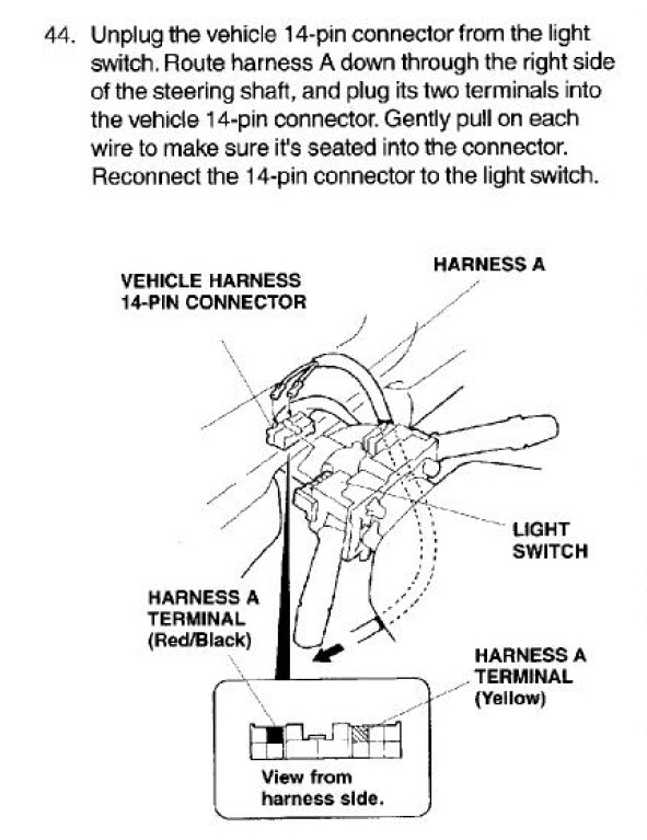

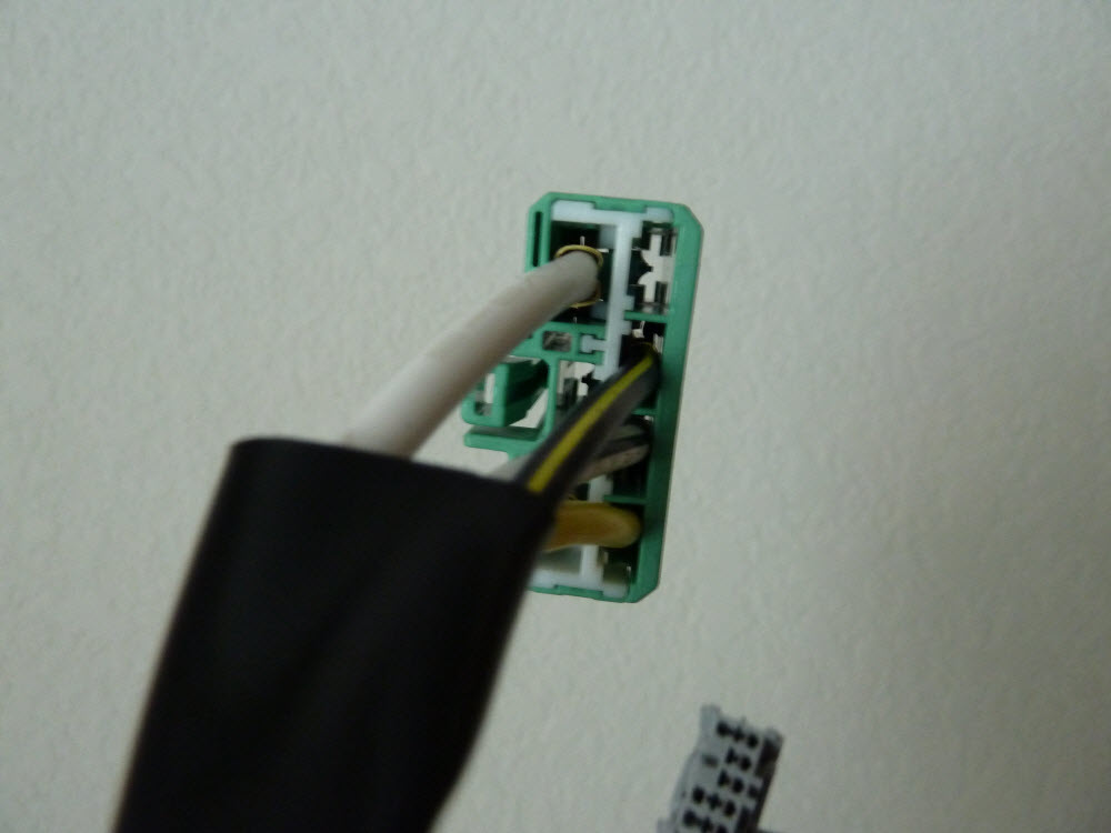

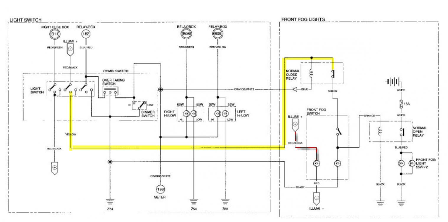

OK spent the money and bought the Honda kit. Now I'm having a problem with the harness in the steering column. The two wires that you have to insert in the dimmer switch plug will not lock in. One is yellow and the other is red with a black stripe. Can anyone pull a print and tell me what those two wires are for, I suspect one is power through the switch when in low beam but not sure. A clear print would help tremendously. Again this is the same factory Honda Driving light kit for 2002 v6 coupe. Thanks....
Old Jan 18, 2011 | 07:52 PM
Posts: 7,101
Sound like you are referring to the Honda fog lights. The wires are part of the fog light harness that come with the kit. Based on the diagram that is part of the installation instructions, yellow goes from the light switch to the fog light relay. The red/black wire is the positive wire for the fog light switch illumination. These two wire (which are part of Harness A) are to be plugged into the 14 pin connector from the light switch from behind the connector.

Old Jan 19, 2011 | 11:50 AM
Posts: 7,101
Originally Posted by soba_03
I can't get the yellow wire to lock in the dimmer switch connector. I put it together any way and they don't work.
It may be a plastic tab inside the harness connector is broken.
Try this. Insert yellow wire with terminal connector through 14 pin connector, then connect 14-pin connector to light switch. Then try to push the yellow wire terminal with your fingers or use a small flat head screwdriver to push the metal connector for the yellow terminal wire to lock it into the light switch.
The attached image is just a connector shown for illustration purposes. There are plastic tabs to lock the terminals in place.

It would seem that the lock on the pin is bad or something. Because the connector lock is moving I can see it when I try and insert the pin. It's so small a pin I"m afraid I'll crush it if I try to manipulate it to much. I even tried pushing it in with a small pair of needle nose. Still no help. So your suggestion is go through the connector with the wire hook it up and then place the connector back over it? should be just 12dc not sure home i'm going to approach it just yet... Thanks for all your help..
Old Jan 19, 2011 | 01:15 PM
Posts: 7,101
I would try to insert the wire with the connector directly first, then from behind the connector, try to push the terminal of the yellow wire into the light switch. The reason I would try this first is because most likely the plastic tab inside the connector will prevent the entire terminal from going through it.
If that failed, then I might try to cut some of the plastic tab inside the connector with an X-acto blade or cut the yellow wire; then connect the yellow wire terminal to the light switch, then afterward push on the 14-pin connector. If the wire is cut, just re-connect the yellow wire afterward.

Got them working, it was right where I thought it was. Got the pins to lock in the dimmer plug finally, did have to walk away from it for about a week. But got in there Saturday and got the pins in the connector and POOF everything work like advertised.. Some minor adjusting and we should be good... Thanks for all the assistance!
