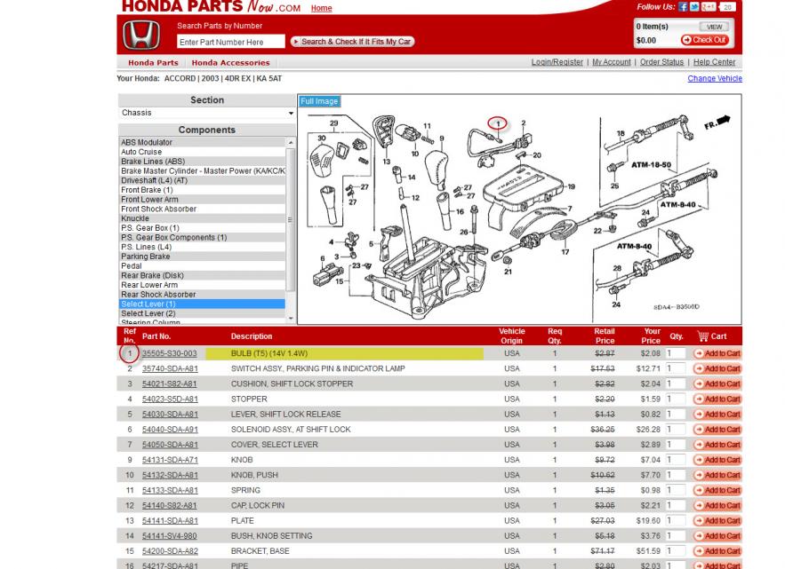

im trying to convert all of my bulbs inside my car to blue. BUT there is that one stupid bulb above my shifter thats yellow. ive been trying to look everywhere to find a blue one but i cant seem to find it. not even the dealership can tell me the bulb size. someone wanna help me out?

The original one is a T5 wedge bulb, 14 volts, 1.4W.

no its some form of led i know that not just a plain bulb.

See attached pic.
