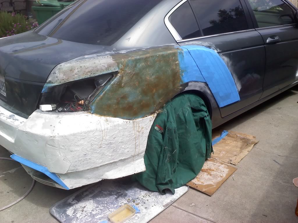

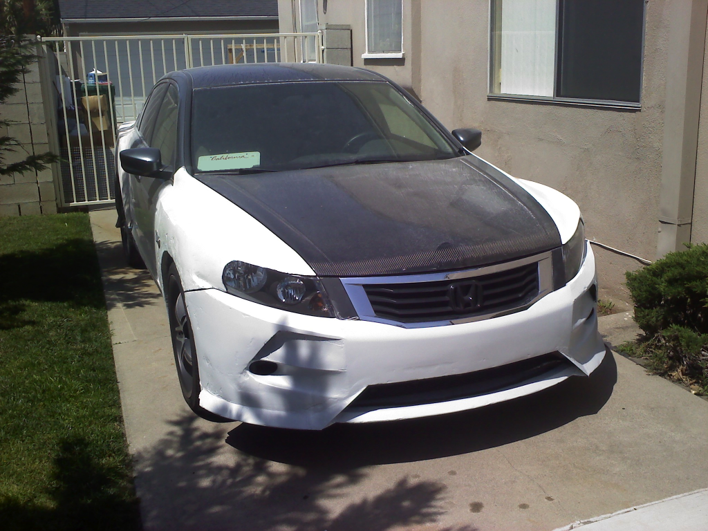

i finally have both side symmetrical and started to fiberglass it. Name:  0327021707a.jpg
Size:  110.1 KBName:  0330021317a.jpg

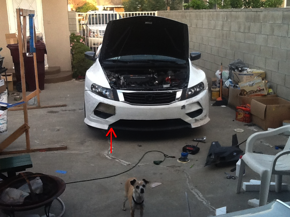

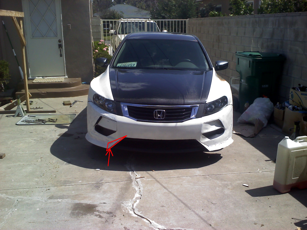

im also finishing the front. i added more to the lip and it really brings out the front the way i wanted. Name:  0319021300.png
Size:  1.26 MBName:  IMG_0377.png
Size:  1.08 MBName:  0408021221.jpg

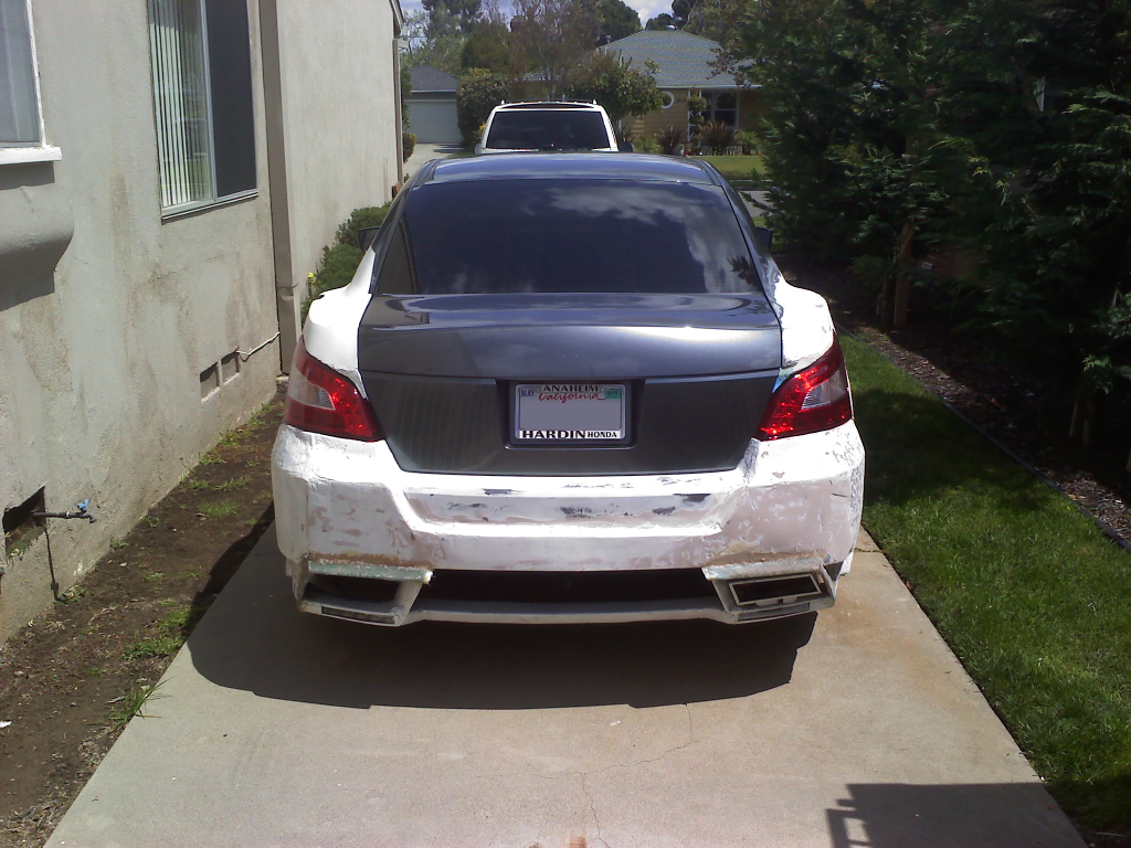

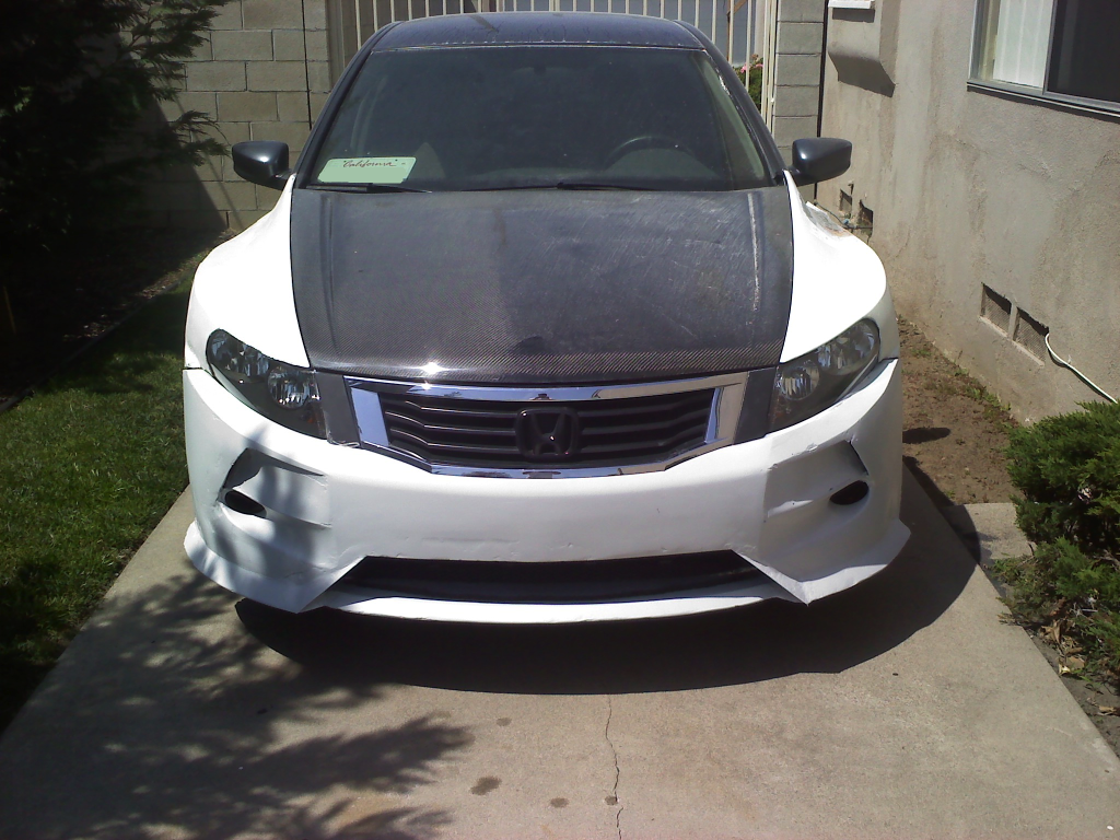

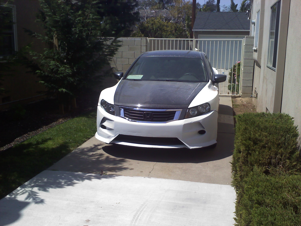

heres the latest pic so far
Size:  1.25 MBName:  0409021155.png
Size:  1.27 MBName:  0409021208.png

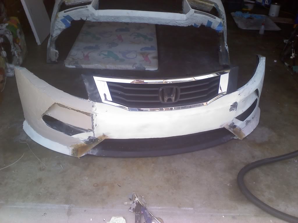

I'm still not done with the front I just paint it wile i work on the side of the car. This is a really big project for me or anyone and I have to change it up so I don't get bored and stop

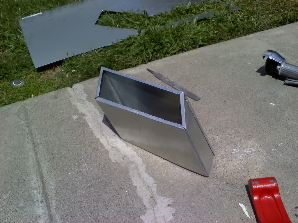

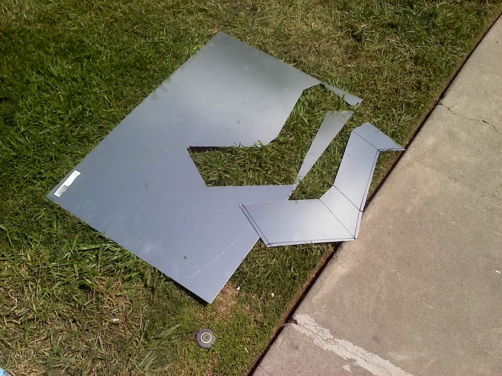

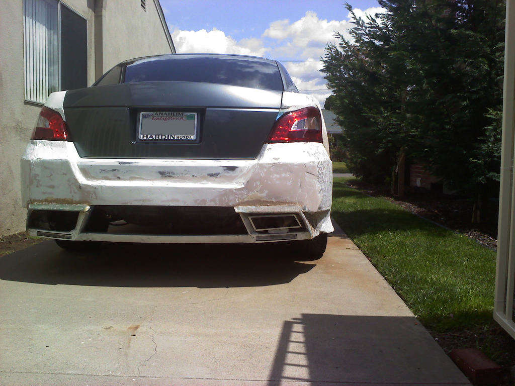

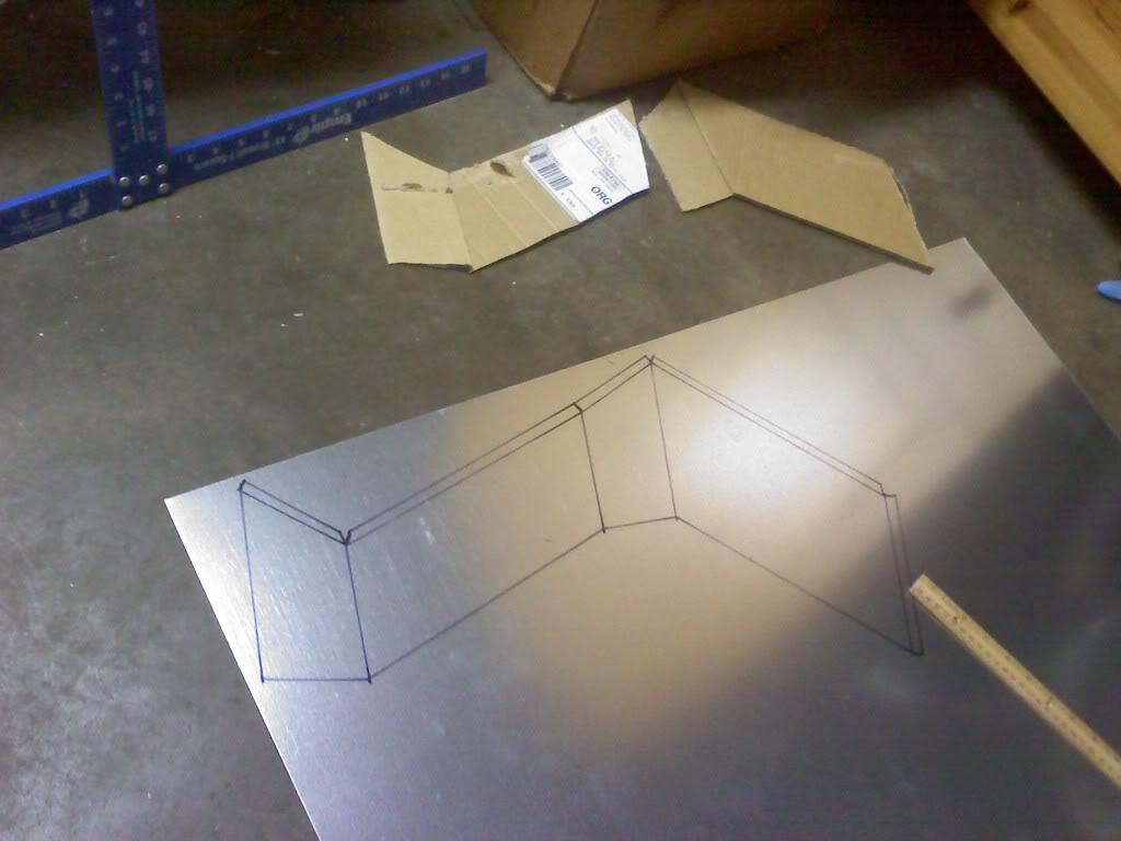

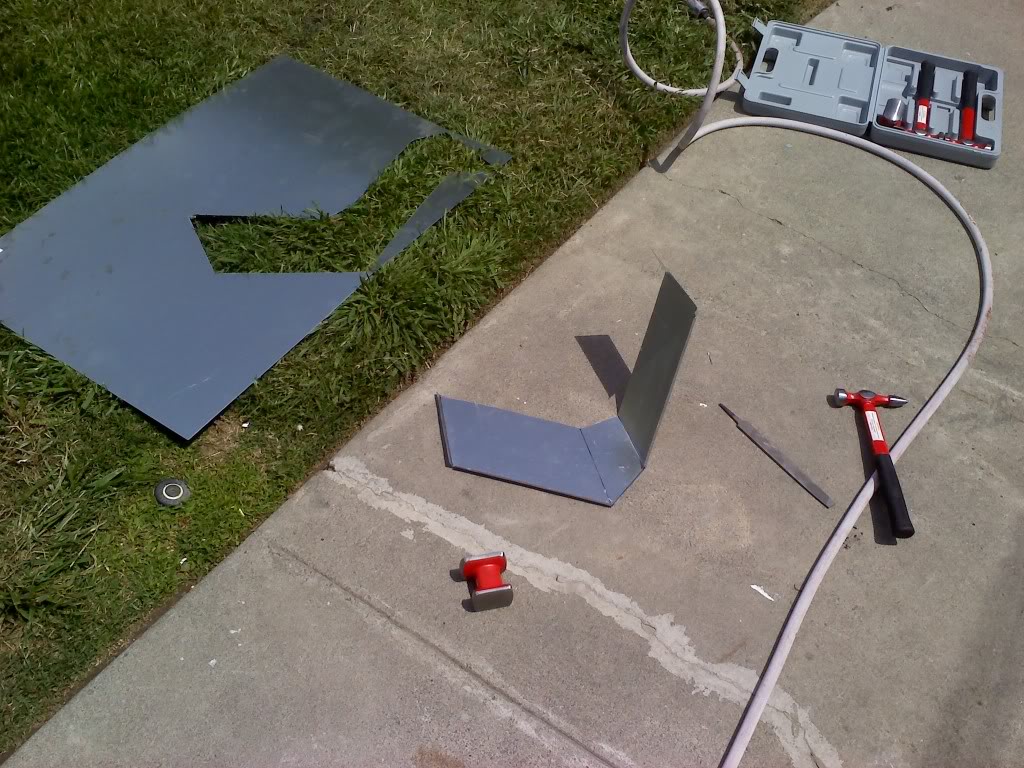

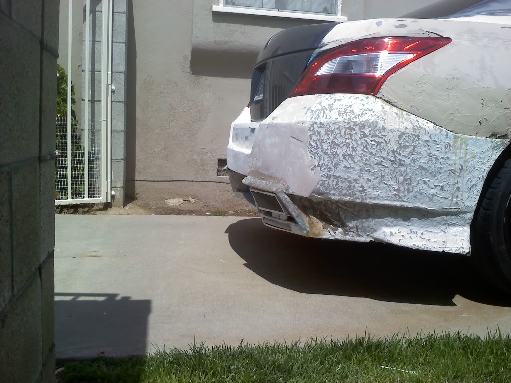

hey let me know what your thoughts are about the exhaust tip??
first i made it out of card boardName:  0411022137.jpg
then i cut it out
then i start the bending
and last i used four rivets to hold it together
how does it look? its not the final i just quickly made this one up so i'll have something to put there.Name:  0412021313.png
Size:  1.26 MBName:  0412021313a.jpg
Size:  139.2 KBName:  0412021313b.png

Originally Posted by Joey6458
i hot glued home depot shaved it into what i liked then covered it with fiber glass
I wanted to know the same thing. So you hot glue styrofoam to the car and then shave it. Then you put fiberglass ove that? How does the fiberglass connect to the solid parts of the car so it doesn't fall off? Also, what is the blue tape for? I think that is tape, is it?
I think what you're doing is amazing and I am extremely impressed by all of your work. I can easily see you getting a job with an automotive design team in the future. Keep a portfolio of all the different iterations of your design and they will see how creative you are.
Last edited by Mikebike125; Apr 13, 2012 at 07:19 AM. Reason: Because this car is so cool and I have more questions!!
Old Apr 13, 2012 | 10:13 PM
  #119
Joey6458's Avatar
Joined: Jun 2011
Posts: 177
Yeah I use hot glue to stick it to the car shave it then I cover it in blue masking tape to protect the foam from the fiber glass, the foam isn't fiberglass safe. The body kit is held to the car on the edge of the foam. It's still a every good hold I mean I'm about 180lbs and I can sit on my front fender. (premade wide body kits are held on the same way)
Thanks for the comment. its been a **** load of work and I still have a lot to go.
