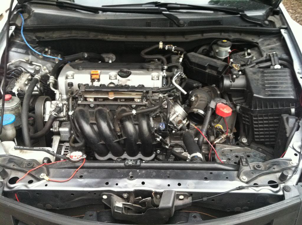

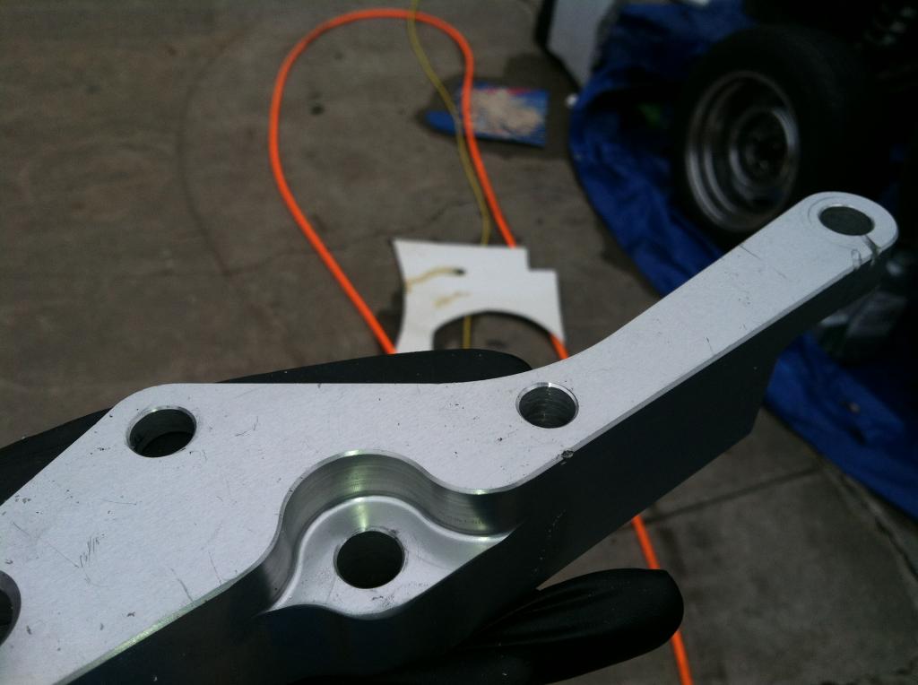

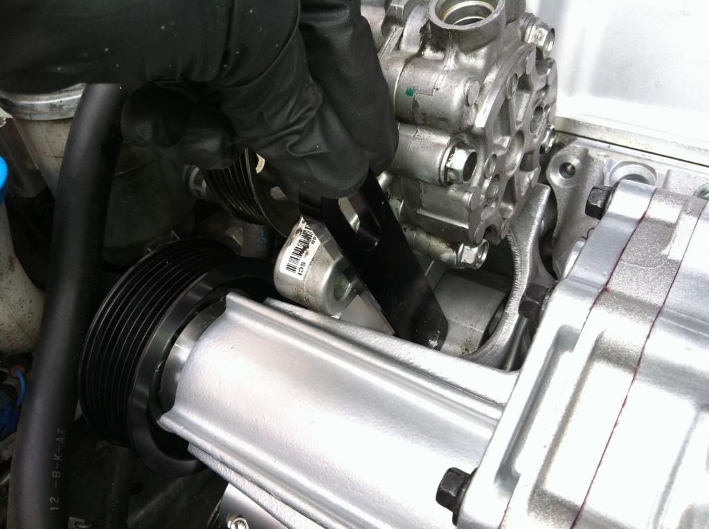

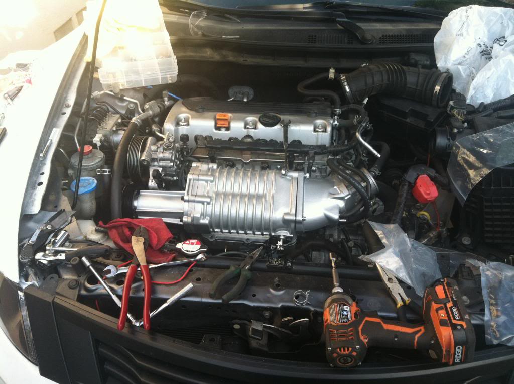

so here is my install

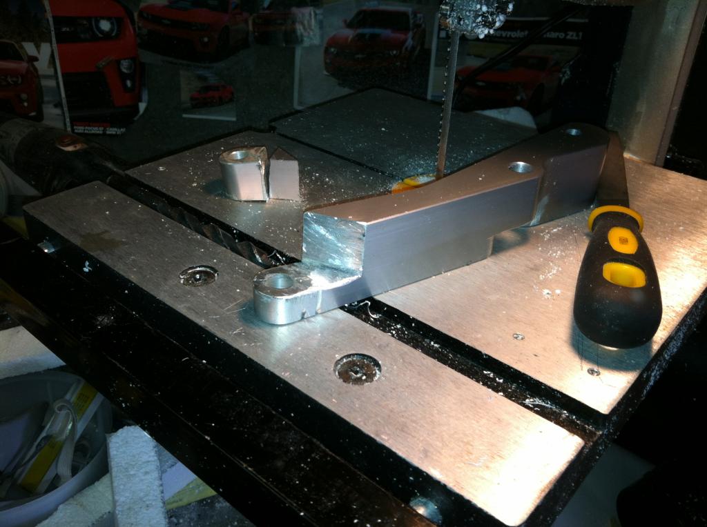

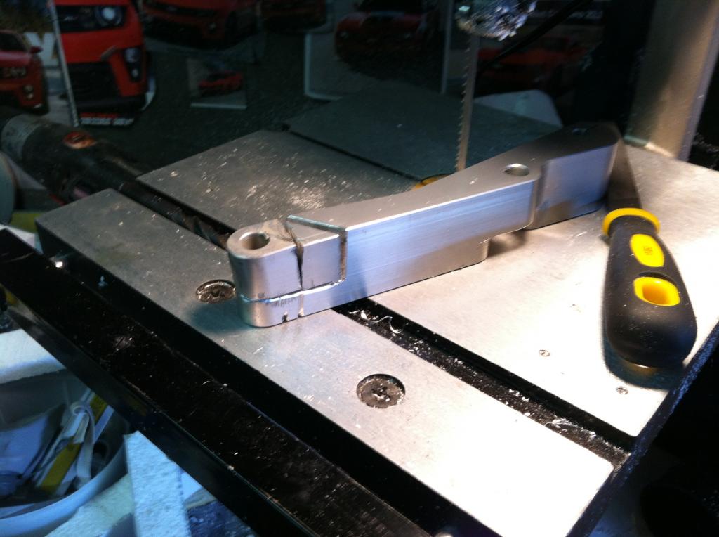

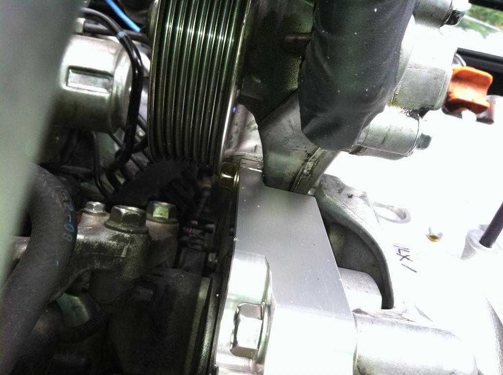

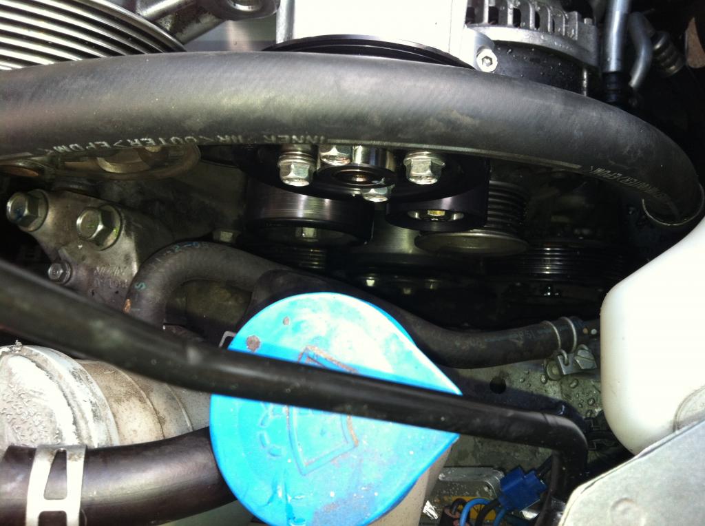

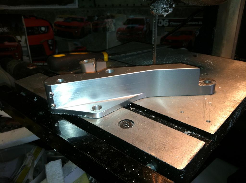

so to start off tsx has an e.p.s.so in order to fit my power steering pump i had to modify the bracket that will take its place
with my new bracket half of the pump is air born
pulleys are straight
the other bracket for the ps pump
im not sure if you can see all them but i now have 8 pulleys lol

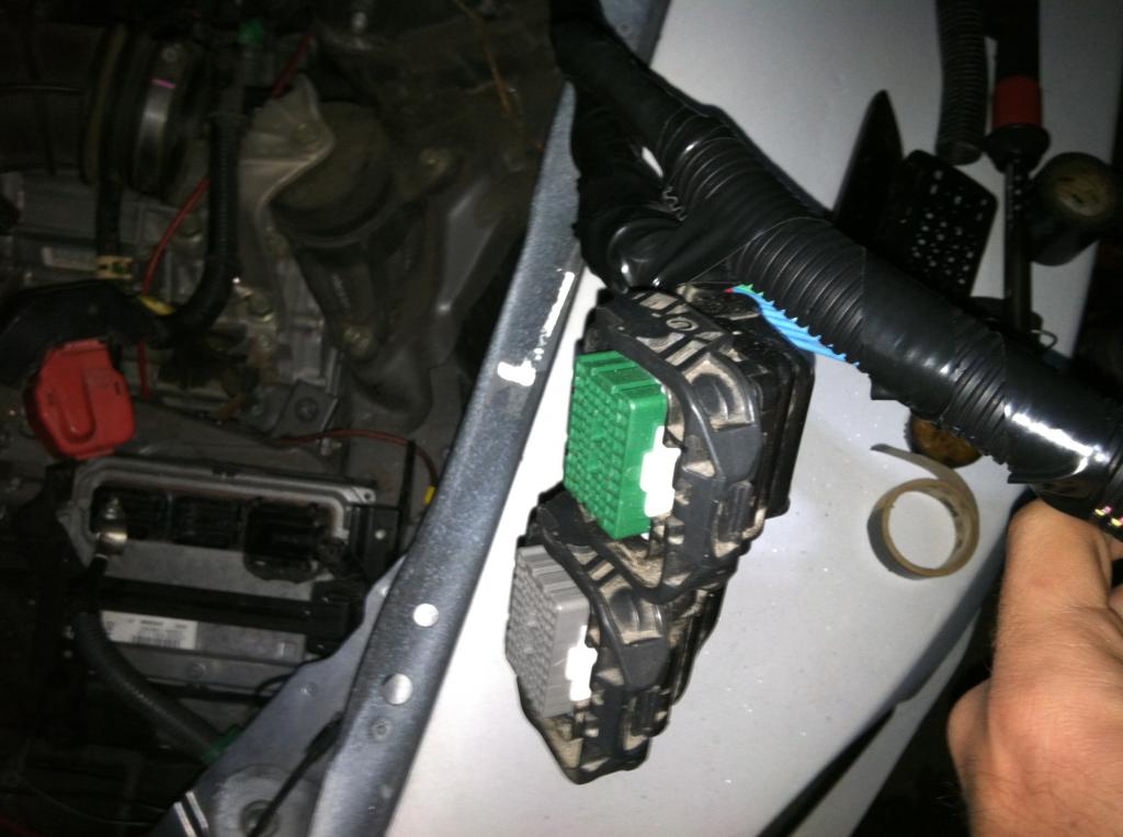

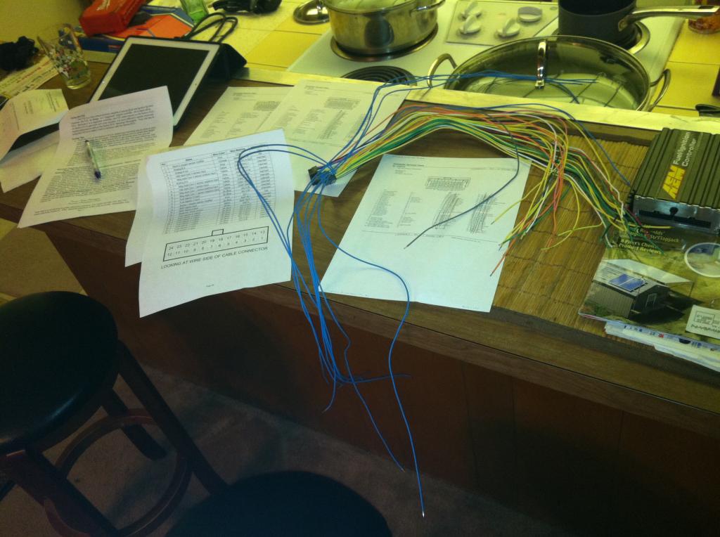

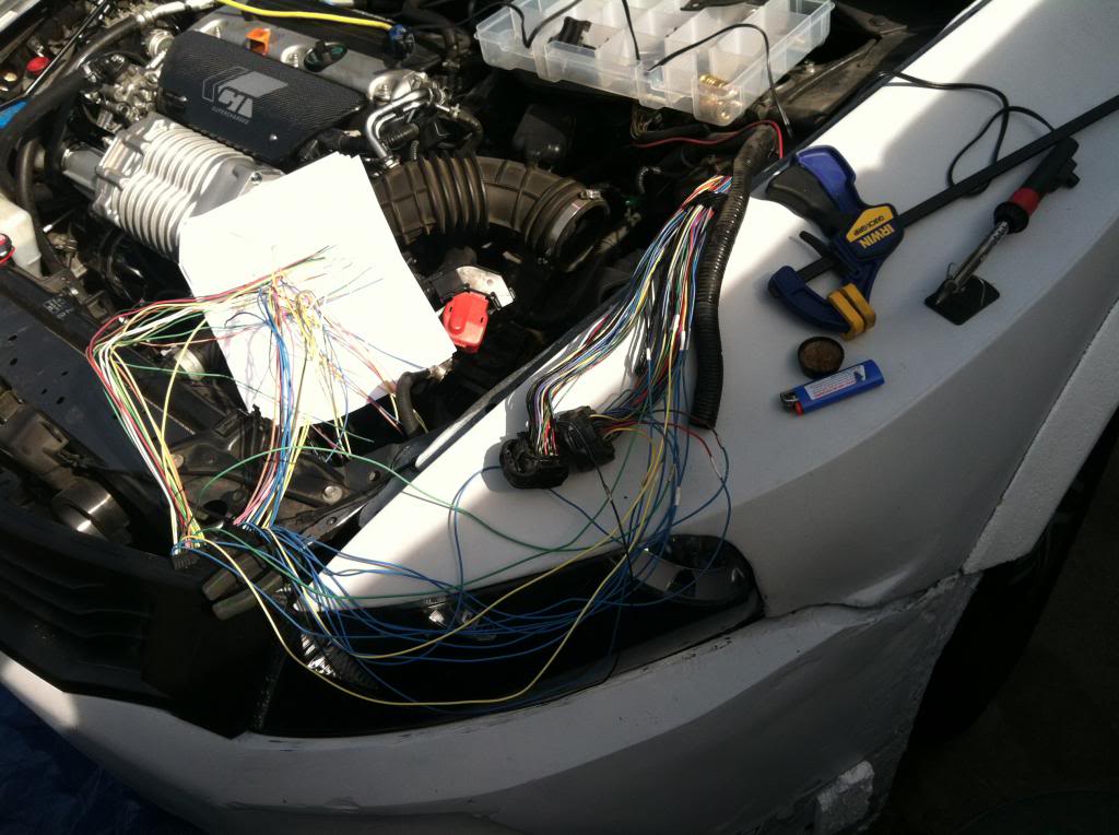

now comes the wiring. so far this is the biggest pain in the ***. the wiring diagram for the ecu (also known as Powertrain Control Module pinout numbers) took me about 3 hours to find. the pinout numbers i found are for the 08 accord coupe but they appear to be the same. for anyone who may plan on scing 8th gen accord i'll post everything i used on a new thread
Attached Thumbnails 2008 sedan body kit what you think?-img_0778_zps8c9e9a1e.jpg
Old Jan 29, 2013 | 02:58 PM
  #195
Joey6458's Avatar
Joined: Jun 2011
Posts: 177
Correction the 08 accord coup has a different pin than the sedan and to my knoladge 06 civic has the same pin out as the 08 accord coup. The differences between the sedan and the coups is minor. The MAF and I think some of the ground are moved. Luckily a guy at my local honda dealer was able to give me a print out of my cars pinout.

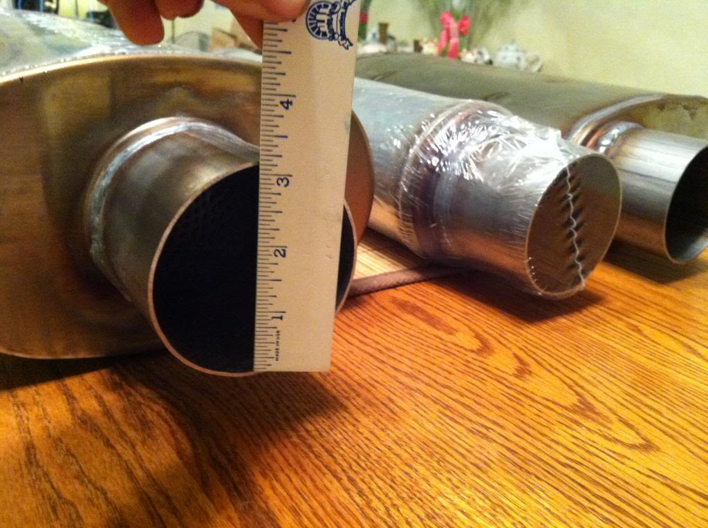

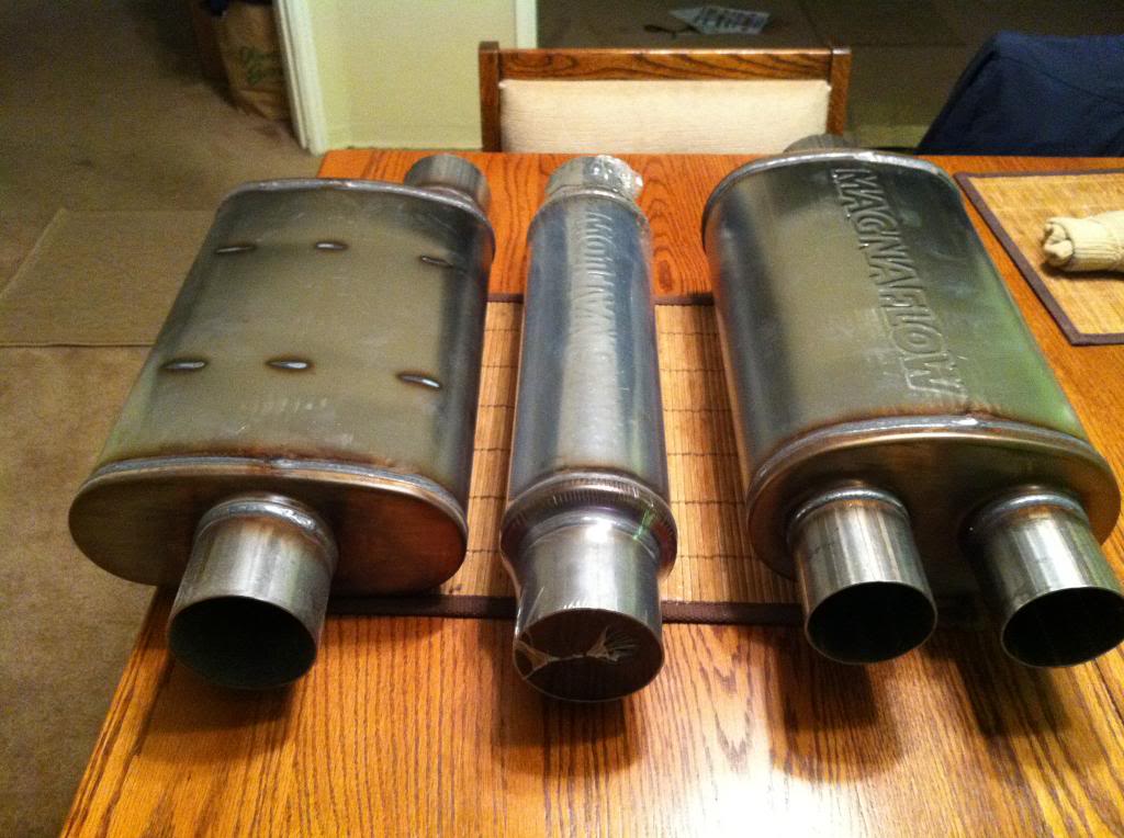

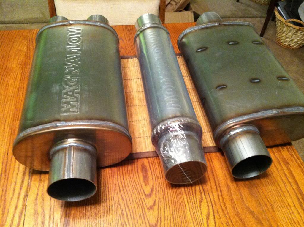

my mufflers came in so now i have to decide on single or dual exhaust???
single would be 3" and dual would be 2X 2 1/2"
and wiring is done!

i went with dual
