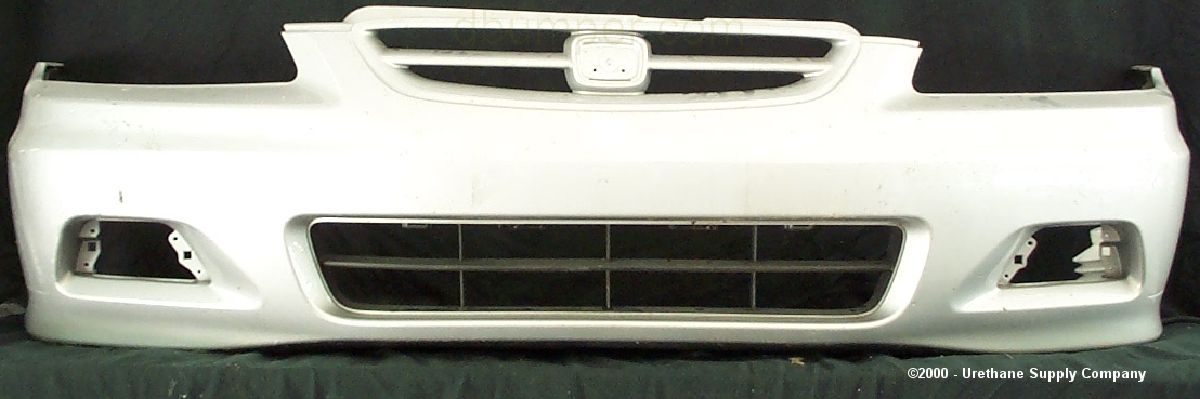

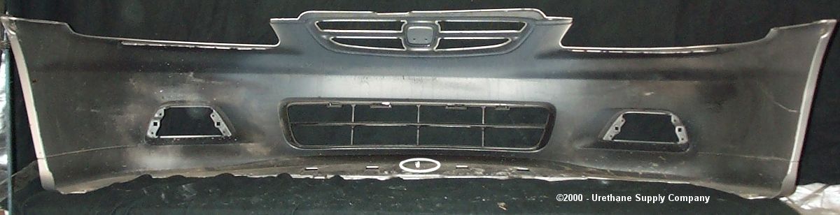

these aren't exactly mine but i feel like i know the grills attached to my bumper because i don't see any creases between them and i can't feel clips/ screw under where i would take off the original grill.
this is the grill i ordered

Yeah your stock bumper is one big molded piece, you'll have to cut the grill out with a dremel or similar tool so it fits the new grill. Measure carefully and cut a little smaller than you think you need at first, it's always easy to go back and make a second bigger cut but you can't undo it once it's gone! If you measure carefully I think you can make it work well, the big question is how to attach the grill once you have the empty space in the bumper for it. I'll consider it for a while and see if I can find anyone who can come up with something, maybe in the meantime someone here will have an idea.
