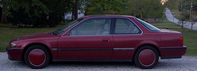

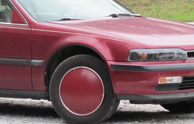

What'cha think? I bought 15" disks from Moon, then first reduced their diameter by about 3/16" on a big disk sander (lol!). The supplied hex-head zinc-plated screws were too close to the Honda rim lip to drive with a socket, so I replaced them with SS panhead Allens.
I marked and drilled the rims, marking the back side of each disk with the corner position and valve stem location, in case the Moon-drilled holes weren't exactly 120° apart.
Anyway - the finish - looks good, huh? I got my local Sherwin-Williams paint store to match the existing faded paint, and mix me up some oil-based "all-surface" enamel.
The Moon disks, as supplied, have fairly deep concentric machining grooves; part of the spinning process and as a stylistic element. So - lots of primer and block-sanding. Then, ROLLED-ON perhaps a dozen layers of 50/50 thinned enamel; usually one or two a day. Then a week to dry, and 600, 1000, then 1500 grit wet-sanding. Then rubbing compound, polishing compound, and a couple coats of Turtle wax.
Also, note where the side-view mirrors used to be - the edges of that little triangular panel are original; the center section I created with fiberglas and Bondo.
Forrest

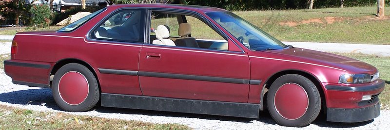

Now an inch-and-a-half lower - may settle more with driving and a tank of gas - it's empty now. Next is an air dam annd side skirts made from vinyl baseboard material -
As I was under the car, I checked transaxle level because it was getting hard to shift - was almost a quart and a half low - from 2 qts, I think. Leaking out.

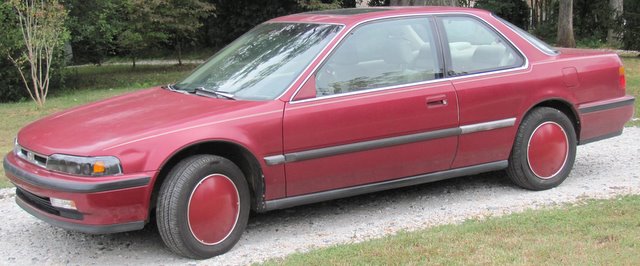

Skirted, mostly -

Now fully skirted and "black chrome" polish rubbed on the conveyer belting -
