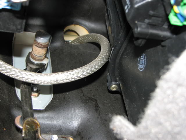

above the gas pedal is a good spot to go through. there is a spare grommet there behind the factory sound barrier material (you can see it in the engine bay). my build log should have pictures.

obviously, this is before split loom and zip ties to hide it, but this pic was to show the location of the wire.

keep_hope_alive...GOOD FIND. I used the opening above the gas pedal and it was a piece of cake. THANK YOU!!!

good deal. you still need a grommet there. you can drill out the plastic grommet for your wire size if it is small enough. always use a rubber grommet to protect the wire and seal moisture.

was able to poke a hole in the grommet without removing the grommet. thanks again
