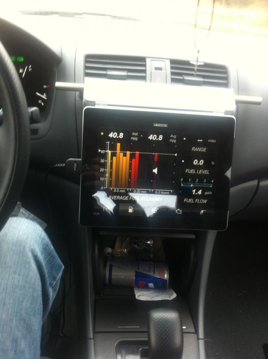

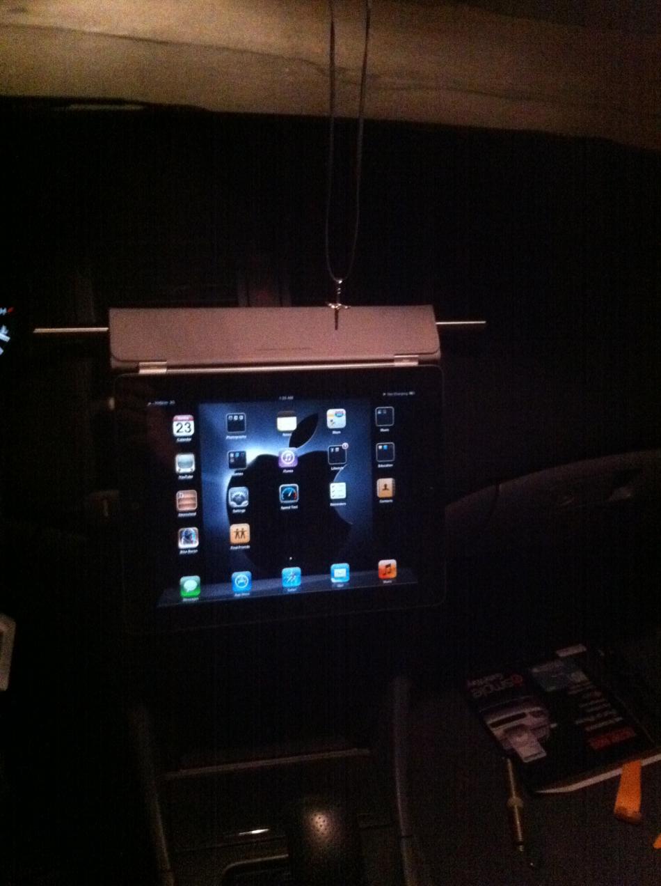

This is my iPad install. I installed the iSimple and Kiwi Wifi PLX with the DashCommand App. I use the 30 pin connector for audio. It is very nice for GPS, monitoring engine diagnostics, MPG and many other things. It seems to be very accurate.

This mounting idea is VERY inexpensive. I took part of the idea from a YouTube video that some guy posted. Anyways, I used the same bar as in the video but I used a different case that's works very well. If you watch the video it explains everything. I then added the iSimple by connecting it to the stock head unit. My goal is to keep everything stock. I then plugged the PLX device into the OBD II socket and leave it there. It is wifi so you do not have to deal with any wires hich is very nice. It has an auto shutoff for the OBD II wifi and the audio when you turn the key off. When you start the car back up the music picks up where you left off. I purchased the 3G iPad 2 because of the main usage of the GPS and I also use Pandora which is a great substitute for satellite radio at a cost of zero dollars. I never have any problems with losing connection on music via pandora because it has a nice buffer. Also, the iPad surprisingly gets charged by the 30 pin cable, but ONLY when the key is off. This is also nice because it not constantly charging the iPad which can cause battery problems down the roads. Apples battery's are design to be drain then filled then repeat for optimal battery life. Hope this addition helps and if you have any more questions feel free to ask

This setup has been working very well. I am glad I chose to use the wireless OBD II system to my iPad. I can record active gas mileage, check speed, exact engine temp, exact RPMs and many other options... and listen to pandora at the same time. I have the 3G model. I use a 30 pin and full sound comes through it, also when I turn off the car and get back in it later, the music pics up were it left off. Also it ONLY charges the iPad when the car is off and screen is locked. :-)
