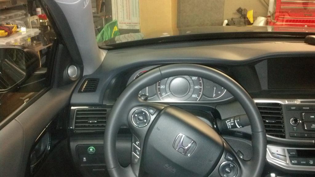

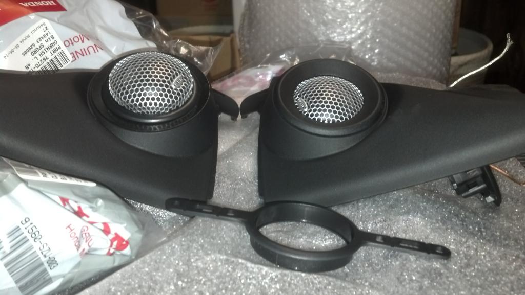

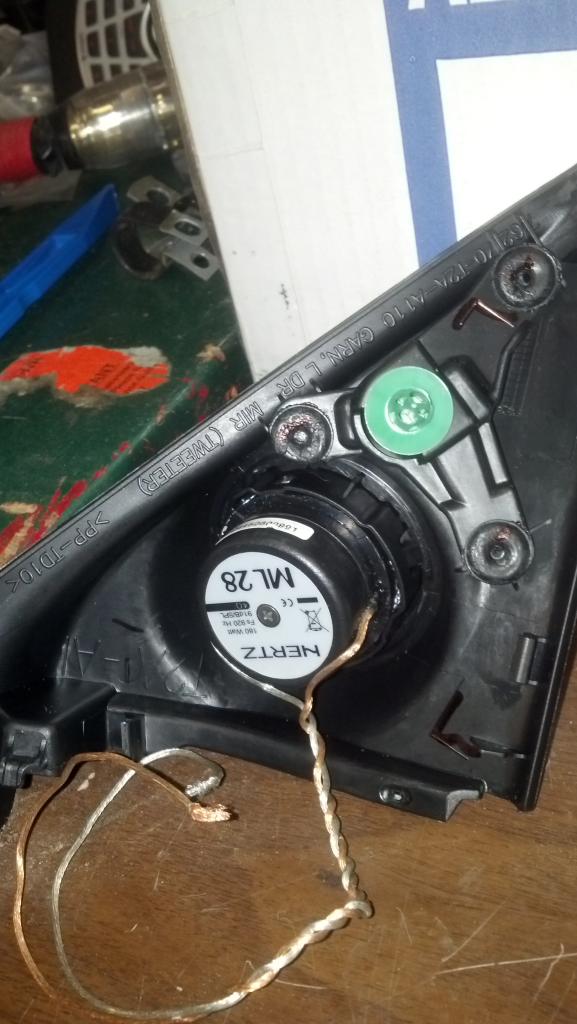

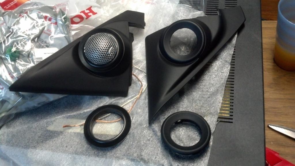

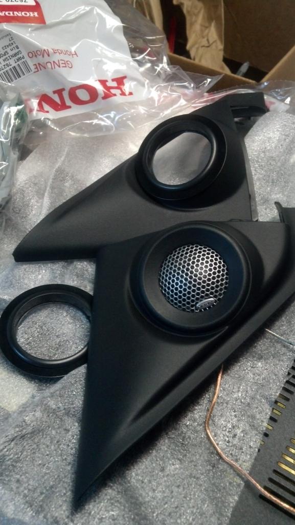

got the EX sail panel tweeter mounts in from HondaPartsDeals.
with the factory tweeter rings the opening is 1-7/16". without the opening is oddly cut and around 1-7/8".
The ML28 tweeters can fit in a number of ways. From behind using the factory rings or in place of the factory rings using Hertz mounts.

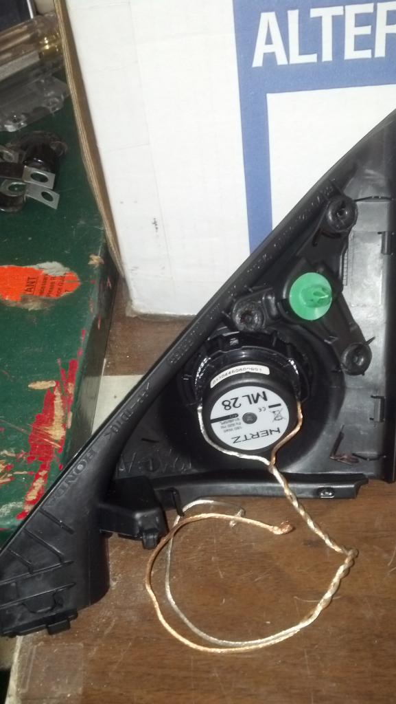

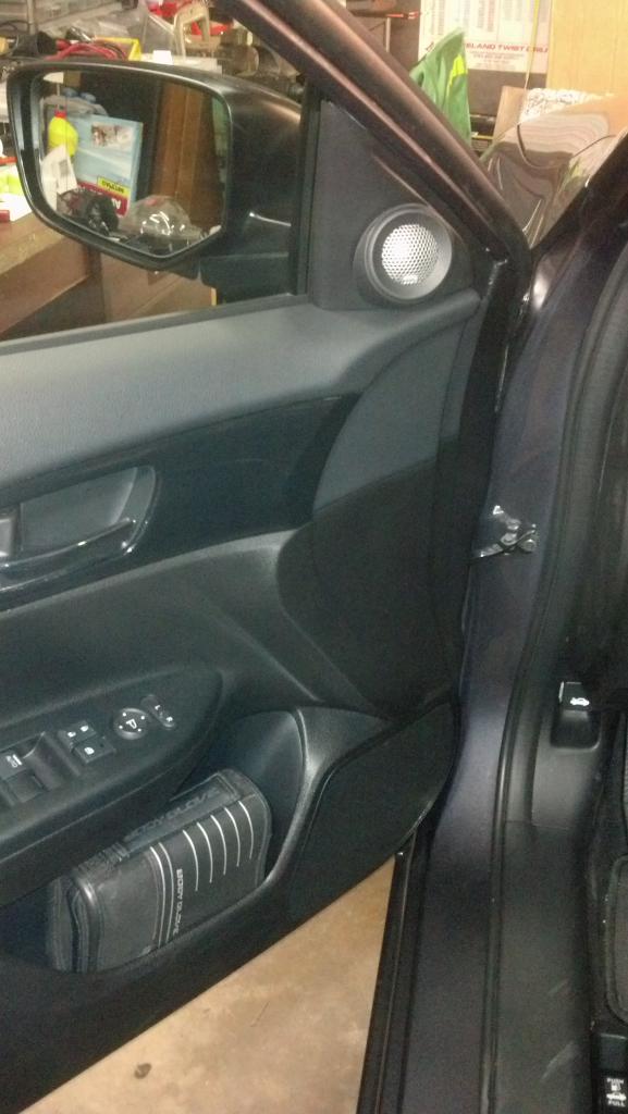

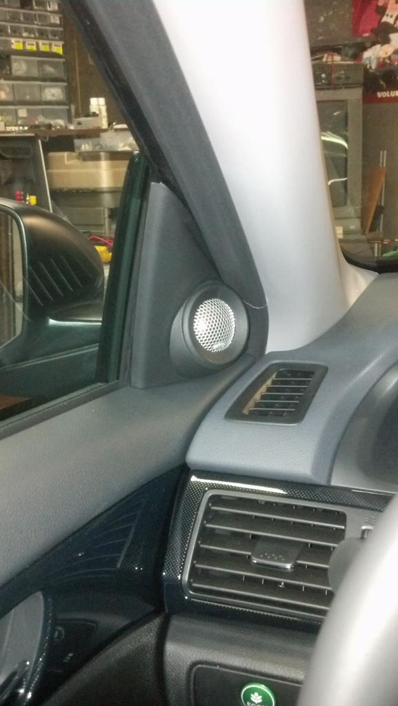

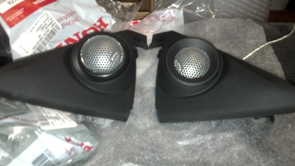

just like it was meant to be, the ML28 fit in the factory mounts perfectly. i was concerned the depth of the ML28 would be an issue but there is a good 1/8" clear - enough for CCF on the sail metal behind the tweeter. these things don't even need adhesive.

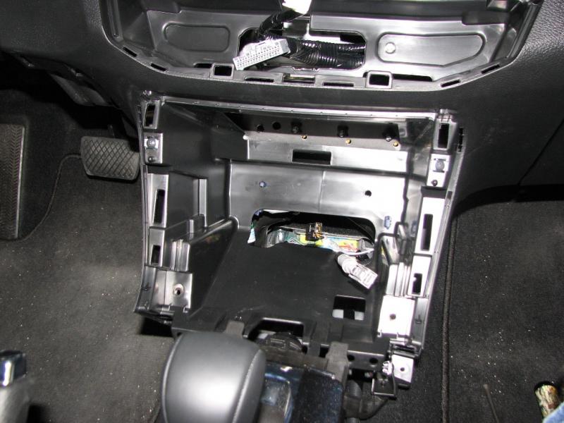

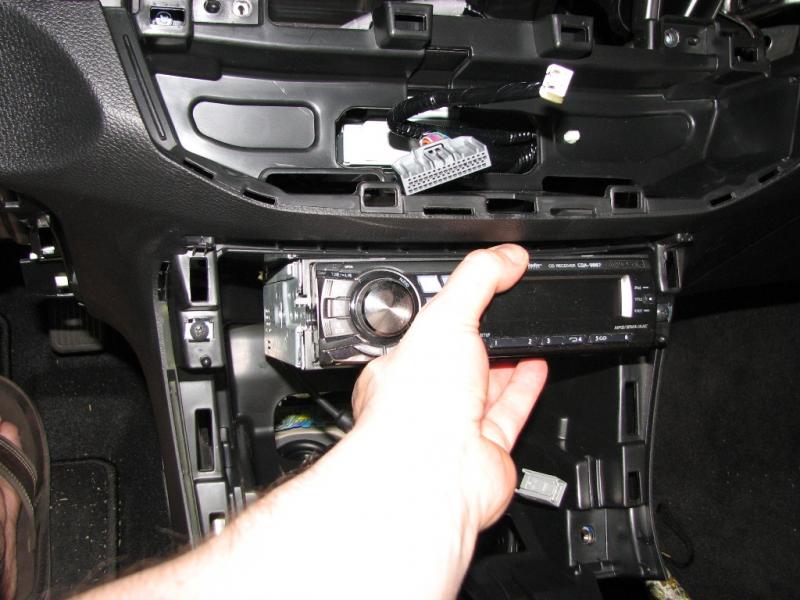

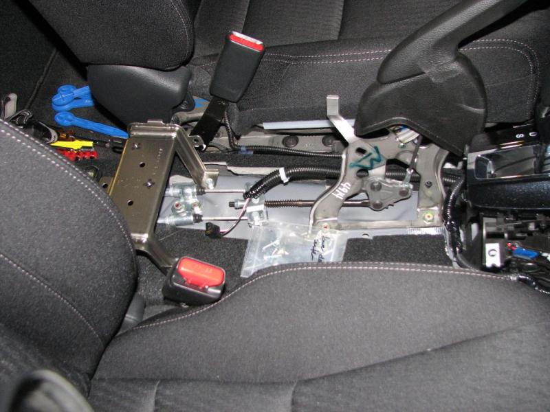

I will make a separate "how-to disassemble" thread.

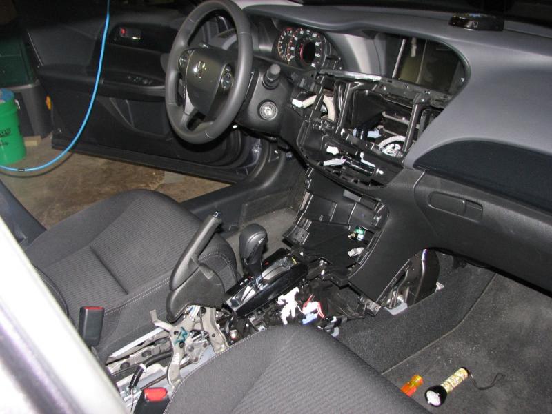

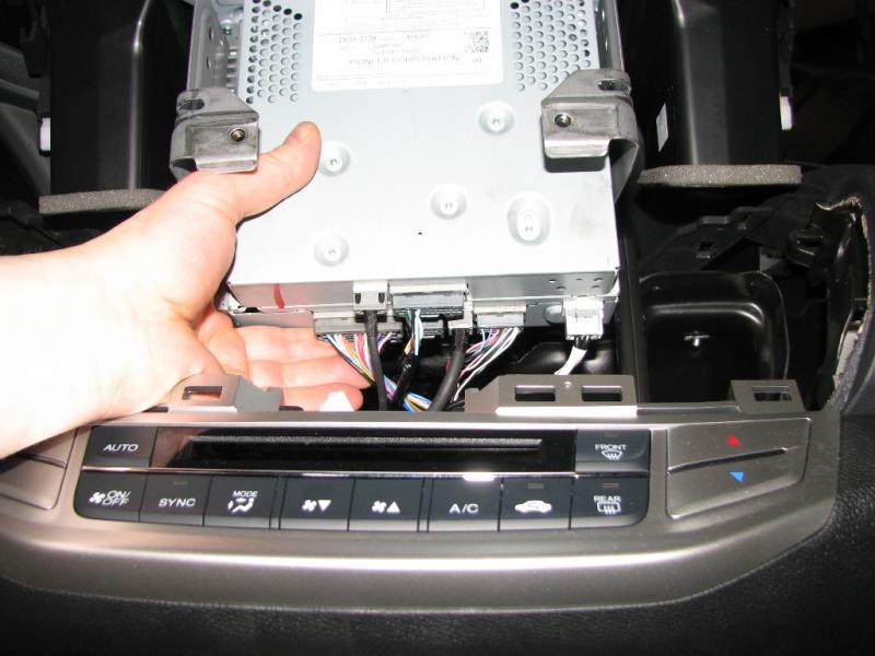

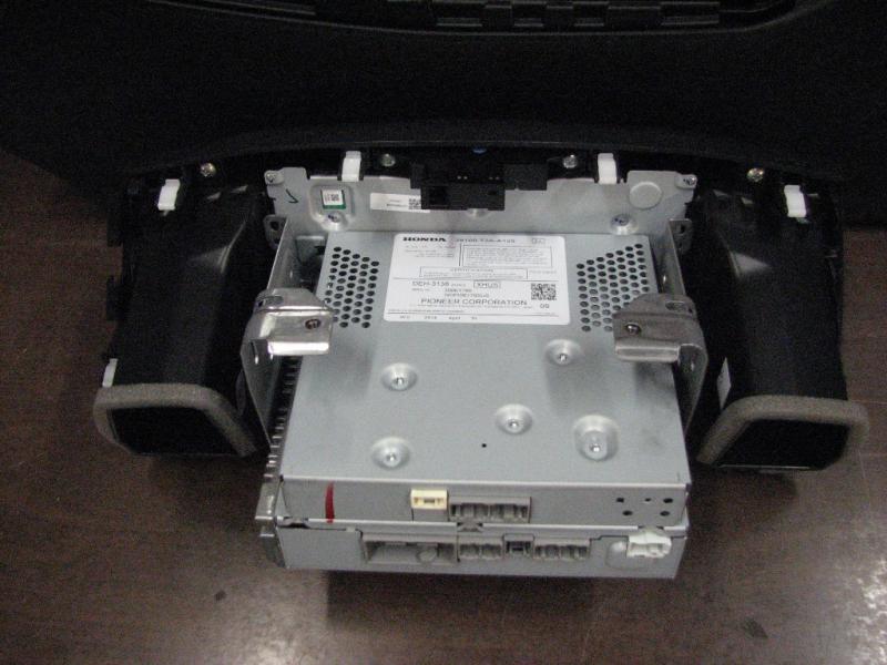

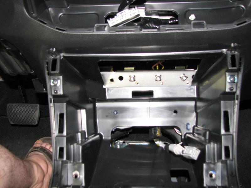

This is where I want the head unit, i will have to cut out plastic at the back of the pocket
The center console comes out very easily and quickly
the factory radio has a nice collection of harnesses
I am bummed it's a Pioneer
