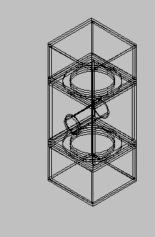

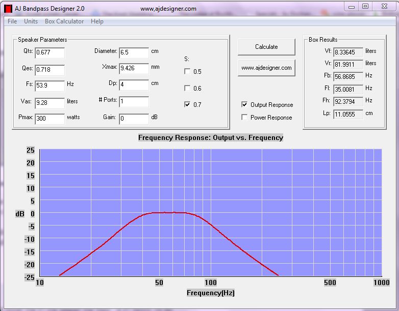

I dont have the money for a 150 dollar program right now. but this is what I came up with using some freeware.
How does it look?
that is just for one sub. I guess I should do it for all four cumulative?
this is just something I drew up based on my extremely basic knowledge of 4th orders (I dont know any adjustments to make for push pull isobarics)
but it is 1 cubic foot ported, then two .5 cube sealed chambers.
4 inch aero 8 inches long. ported section (stand alone) should be tuned somewhere around 40 hz.
Attached Thumbnails Side Project.-iso4thorder_zps5ef04674.jpg   Side Project.-iso2_zpsb9818887.jpg
