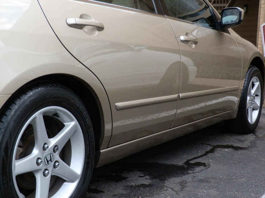

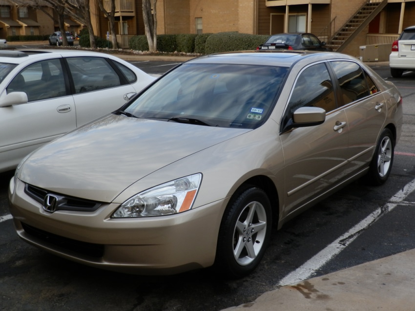

My own car:

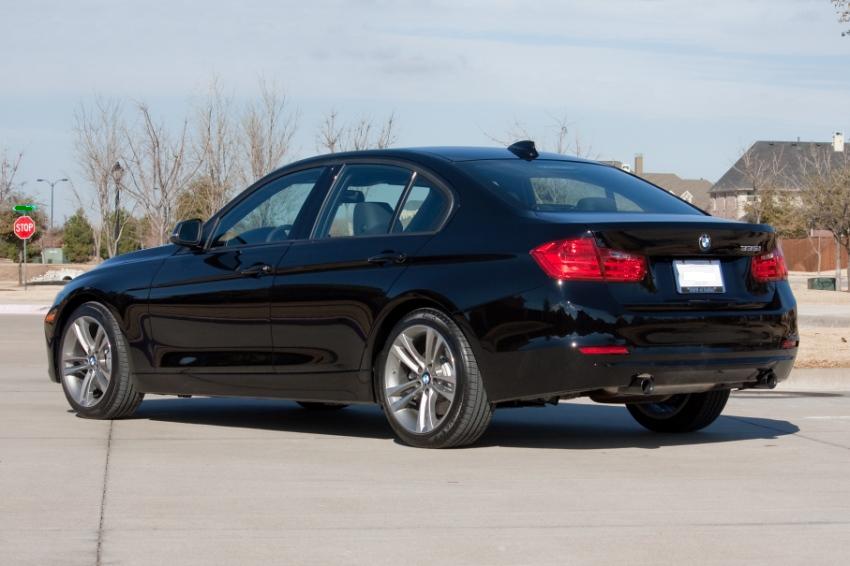

A customer's car-he took the pics and sent them to me
