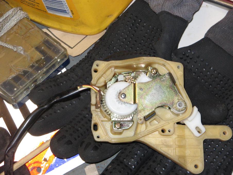

The Left Rear power lock actuator on my 94 EX just buzzes when actuated and does not move the lock. I decided to remove and attempt to repair using this thread and 1A Auto DIY video (
The 1A Auto video recommends removal of the entire door latch assy w/ actutator to access the actuator, rather than remove actuator from in-place latch assy as recommended in this thread.
I elected to remove door panel, inspect, and decide which way to procede. Upon inspecting the access, the three actuator retaining screws and one cover retaining screw were difficult to access and I decided to remove latch assy w/ actuator.
I had no problems w/ latch assy & actutor removal, but getting the assy by the window channel guide is a bit tricky. Also, the latch assy screws (3) are very tight and may require an impact driver or other tools to release.
Once the latch assy and actuator are removed, it is straightforward to separate actuator from latch assy; remove single cover screw and three actuator retaining screws.
I removed the actuator cover expecting to see crushed rubber stops, but found the stops in pristine condition. I rigged a 12v power supply to test the actuator and found the upper drive gear and actuator spur gear did not move when lower actuator motor and drive gear turned. There is apparently a clutch mechanism between the lower drive gear and upper drive gear to provide some slippage when stops are reached.
I was about to throw the actuator away and order a new part when I noticed a small spring beneath the lower drive gear. It had a plastic piece behind outer end which I initially thought was a shim to compress the spring, but on closer examination I found it was a retainer that had broken away from lower drive assy body. This released almost all compression in the spring. I immediately wondered if additional compression might cause the clutch mechanism to engage. I rigged a wood chip to provide some compression of the spring. See first pic below. You can just see the small compression spring between the wood shim and drive assy. Upon testing, the drive mechanism worked as intended and spur gear pushed against stops in both directions when power was applied.

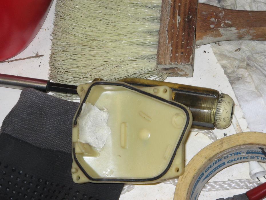

The 2nd pic shows the upper case cover w/ masking tape inlaid to provide confinement of the wood shim and hopefully prevent it from "walking" out of position. Chip was sized to fill most of the space and hopefully spring compression will hold chip in place also.

In summary there are at least two ways the actuator can fail, and a 2nd repair option is possible.
