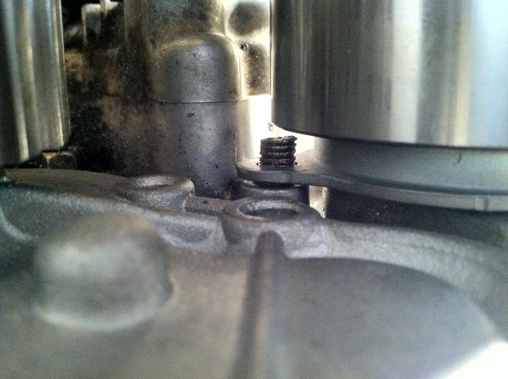

New member. Your post helped us tremendously. 94 Accord has 315K miles on it. Timing belt changed only once before. The one we took off looked like new but we're changing it to prevent changing the whole engine right? Well the stud you spoke of for the inner tensioner was broke off apparently on the first TB change. After careful analysis we decided to drill a hole where the stud was. Then cut 4 horizontal lines on a bolt to act as a tap. We worked the bolt in with some oil then put some lock tight on, and then hack sawed the head off leaving a new "stud". Worked great. You need this stud so the spring can place the correct tension on the tensioner. Pros change in 3.6 hrs. Our learning curve took 3 days!

Can you give me some details on your repair of the broken pivot piece and how you fixxed it? I'm dealing with the same issue right now and have been trying to come up with a solution all night with no luck. I thought about drilling a hole and putting some kind of a bolt or something in it I was just unsure about how far I could drill into the engine right there and how far I would need to have the bolt into the hole for it to hold up after the tensioner is back on it
