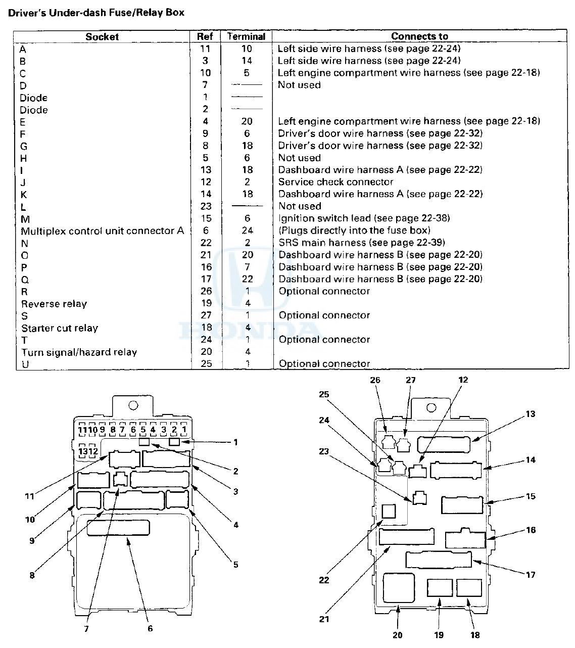

There's 3 fuseboxes in the car. Under-hood, & both ends of the dashboard (have to open the doors). Which box has that 7.5A fuse you mention? If it's the drivers side dashboard, then it's only supposed to have power when the key is turned to START.
Since that didn't light up when you turned the key to START, that points to any of the things "upstream" from that point.
1 - In the under-hood fuse box, #41 (100A) and #42 (50A) fuses. Those are bolted down and if they were blown there would be a whole pile of other things that don't work.
2 - A flaky ignition switch. Check whether you get voltage in 2 of the sockets for the starter-cut relay. That's not very unusual, and the electrical part of the switch can be replaced - take off the plastic shrouds around the steering column.
3 - Bad starter-cut relay. Rule out the other stuff first.
4 - Bad clutch interlock switch (near the hinge of the clutch pedal). (Maybe the switch is OK but bent out of proper position?)
