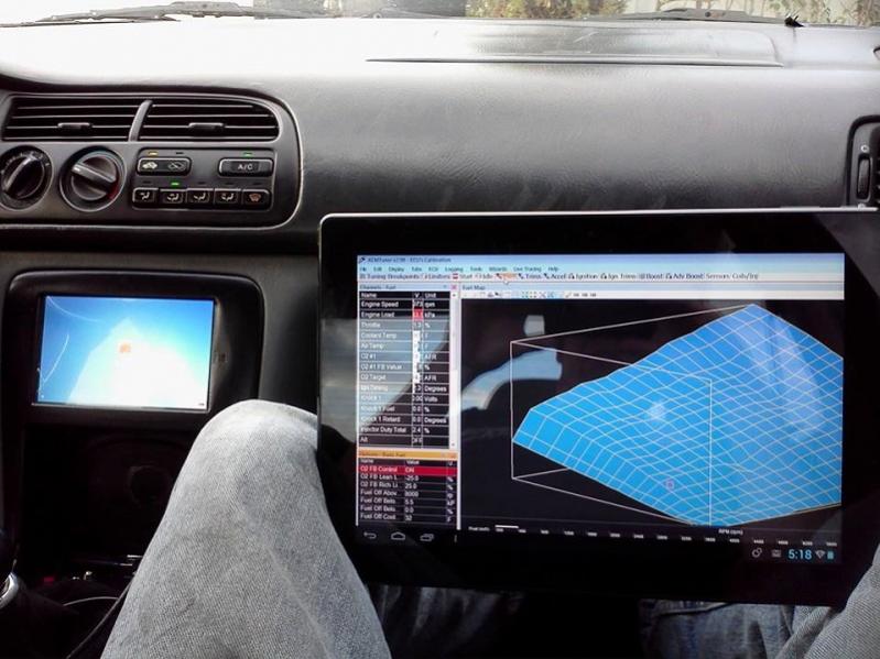

I think it is weird that we take an engine made from 98-01 and drive it with a controller from 92-95. i went with a wideband driven aem ems-4 with optical cam&crank sensor(epm) and 4 k20/k24 ignition coils. this setup even let me keep my variable length intake runners. there is something to be said for real time tuning and o2 feedback at wide open throttle. i also installed a carputer so access to real time tuning can be a constant whenever the car is running. then i got a remote desktop app so i can wirelessly tune my car from an android tablet.
