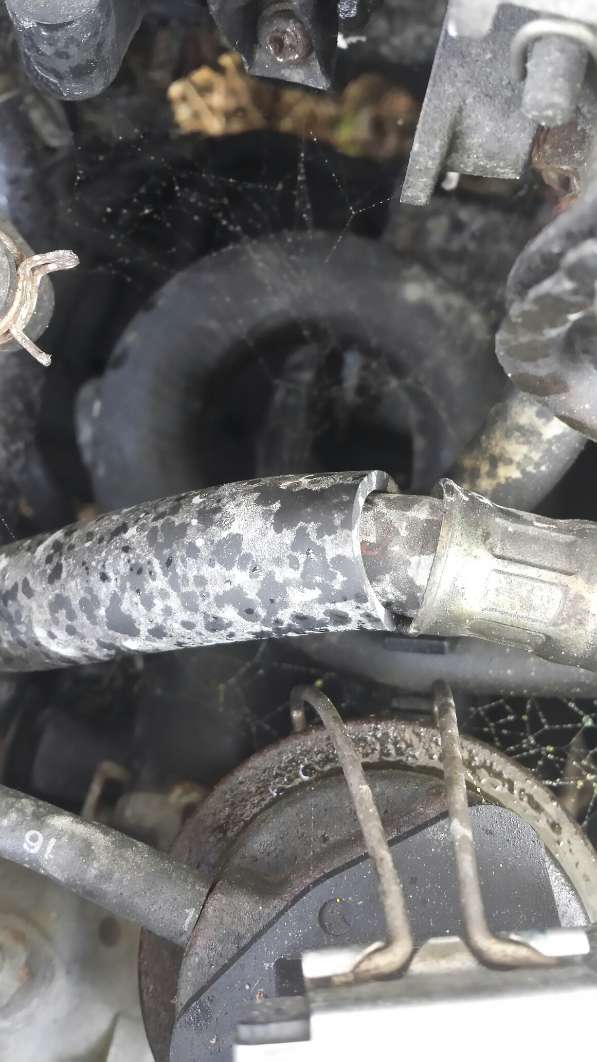

OK so I filled the radiator up with coolant and to be amazement and happiness. The head gasket is fine. It is indeed a cracked hose. The hose leak is fairly small but I can see how it'll get worse with pressure build up. I have taken a picture of the hose that needs to be replaced. Here it is in the first picture. It's below something that I don't know what it is. I'm guessing it's possibly a fuel pump? Let me know. The unknown peice im referring to is the shiny piece in the middle of the second picture. I'd love to get my car up and running before Monday morning so I can get to work.

I can't make out where or what hose is leaking by the pictures.
Can you remove the hose and take it to the local parts store and have them match it up.
