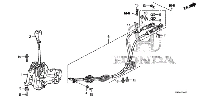

I'm sorta guessing here, but it almost looks like the clips (#11) can be positioned in different places on the cable. But this picture really doesn't show it good enough to know if that's true...

If those #11 clips don't give you any ability to adjust, then the next thing I'd do is open the console to see if anything is loose or ?? at that end of the cable. Those large things just above the #4 # 15 parts clip into the "C"-shaped opening on either side of the shift-lever assembly. Maybe something is loose back there?
