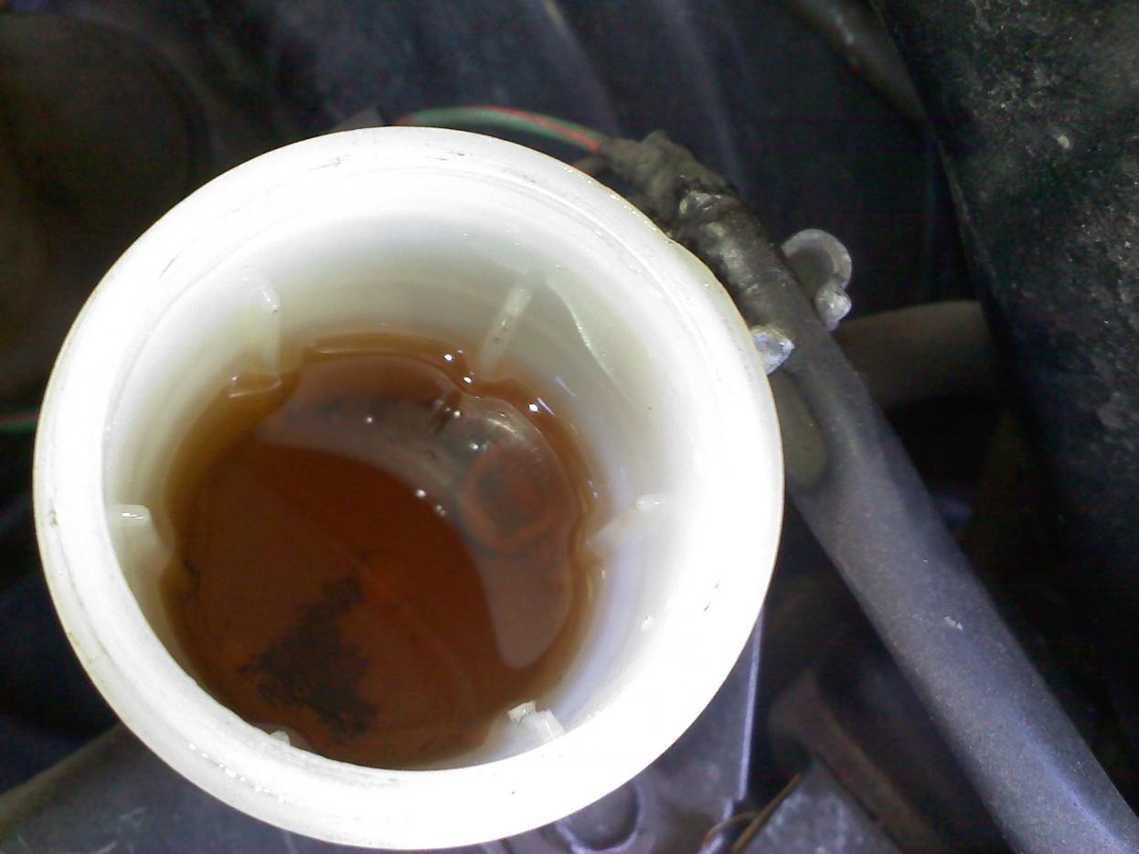

Here are some pictures of what the fluid is looking like.

looks like the clutch fluid filter i knackered more than anything; i say this cuz the fluid is clear except for the sediment.

Is there a clutch fluid filter? I know there's a transmission fluid filter... (Automatics only?) Anyway, I'm going to just bleed all the fluid out tomorrow morning, and replace it with some DOT 5 Fluid unless someone instructs me otherwise, since the weekend is over. Hopefully that won't burn...
Old Sep 28, 2009 | 08:56 AM
DON'T use DOT5 (silicone) fluid. Not good for the seals & stuff.
Use DOT3 or DOT 4. Clutch wouldn't really need the higher boiling point of DOT4.

The fluid doesn't generally burn, since it doesn't get that hot. I've noticed that it gets kinda brown with age, I always figured that was from moisture absorption. If it's never been done, the fluid might be 10 years old??
You're changing it anyway, so just flush enough through, so it comes out nice & clean.

I haven't had time to change it yet, but It was changed about 8 months ago haha, which is why I'm a little concerned. If you have any thoughts as to why it would change color so soon, please let me know.
Old Oct 1, 2009 | 06:54 AM
Yeah, 8 months is pretty fast to get that color. Was the fluid flushed? Or simply fresh fluid poured into the reservoir with old fluid in the lines?
