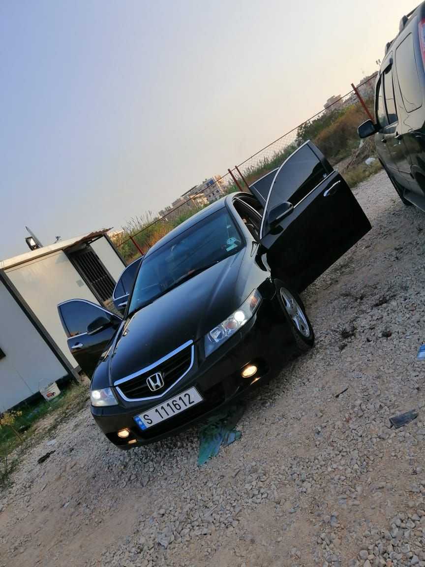

Hello Honda holics
got a 2006 Accord with vin number JHMCL96905C215844
I'm looking for an ECU
the ECU in my car got a part number of 37820-RBB-E54 ; I'm searching the internet for one(mainly ebay)
but the majority of results is showing 37820RBBA54
would this start my car or I need the one ending with E54?
kindly advise

yes the car is EUDM (originally for Germany)
one thing is that Honda says that the part number has changed to the one below
so if I find one in the scrap with this number below would it start my car?
37010-RBB-309
