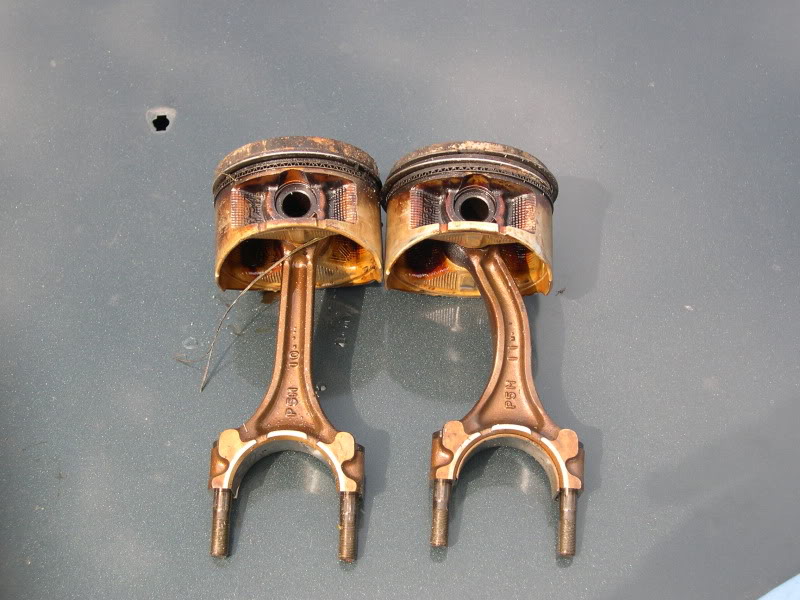

when I did this to my h22 I had to beat my pistons out of the block. I also had a bent rod
