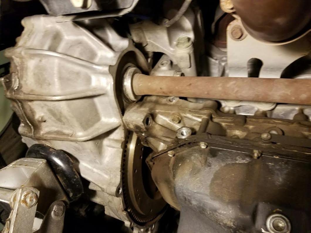

Anyway, I got all the bolts off that SHOULD have allowed me to pry the transaxle from the engine but it's not coming apart. Standing in front of the engine, I can get some space in between the two but it's not budging in the rear. I'm guessing something is holding it together.
I only took the drive shaft on the driver's side off. I'm wondering if maybe the drive shaft from the passenger side wheel (see attached image) is what is keeping it together? What do you think?
Image was taken while crawling under the engine space headfirst from the front of the car. I am looking up into the engine towards the left (driver side). At the bottom left is the jack placed underneath the transaxle/engine.

At some point that shaft is going to need to come out, so you might as well go ahead and remove it.
