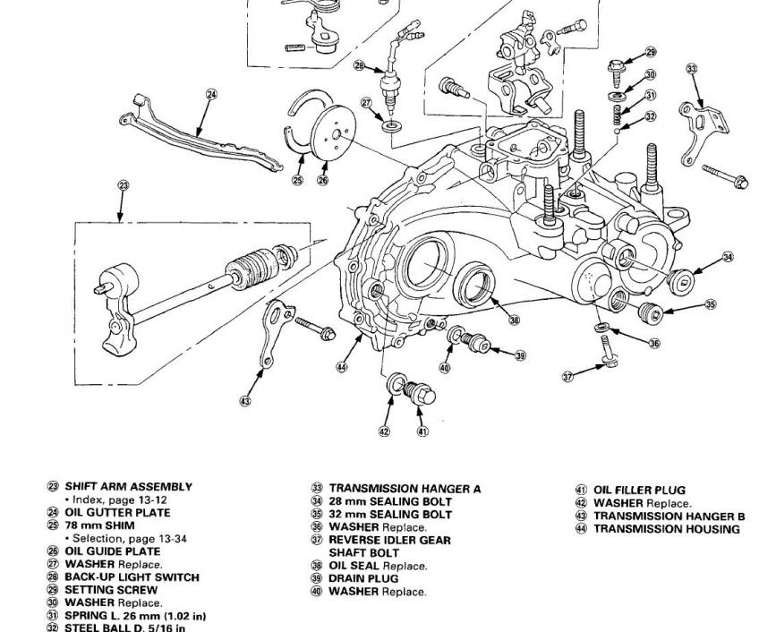

Can i find a dipstick for my transmission fluid..... i dont have one lol, bought the car like that.... fyi 94 dx accord MT
Old Jan 4, 2013 | 08:57 AM
Doesn't have one that's why you can't find it.
Old Jan 4, 2013 | 05:33 PM
No stick.....a check/fill plug (#41 in this pic)....on level ground the check/fill plug is removed and the fluid should be "right at" the hole.
If you are not sure of the age of the fluid I would change it....remove the drain plug (#39 in pic - insert 3/8 ratchet into hole to remove/install) to drain....then refill thru the check/fill plug....of course you reinstall the drain plug before refill
