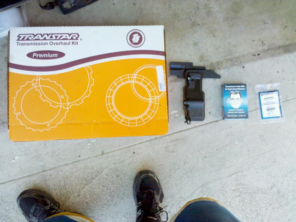

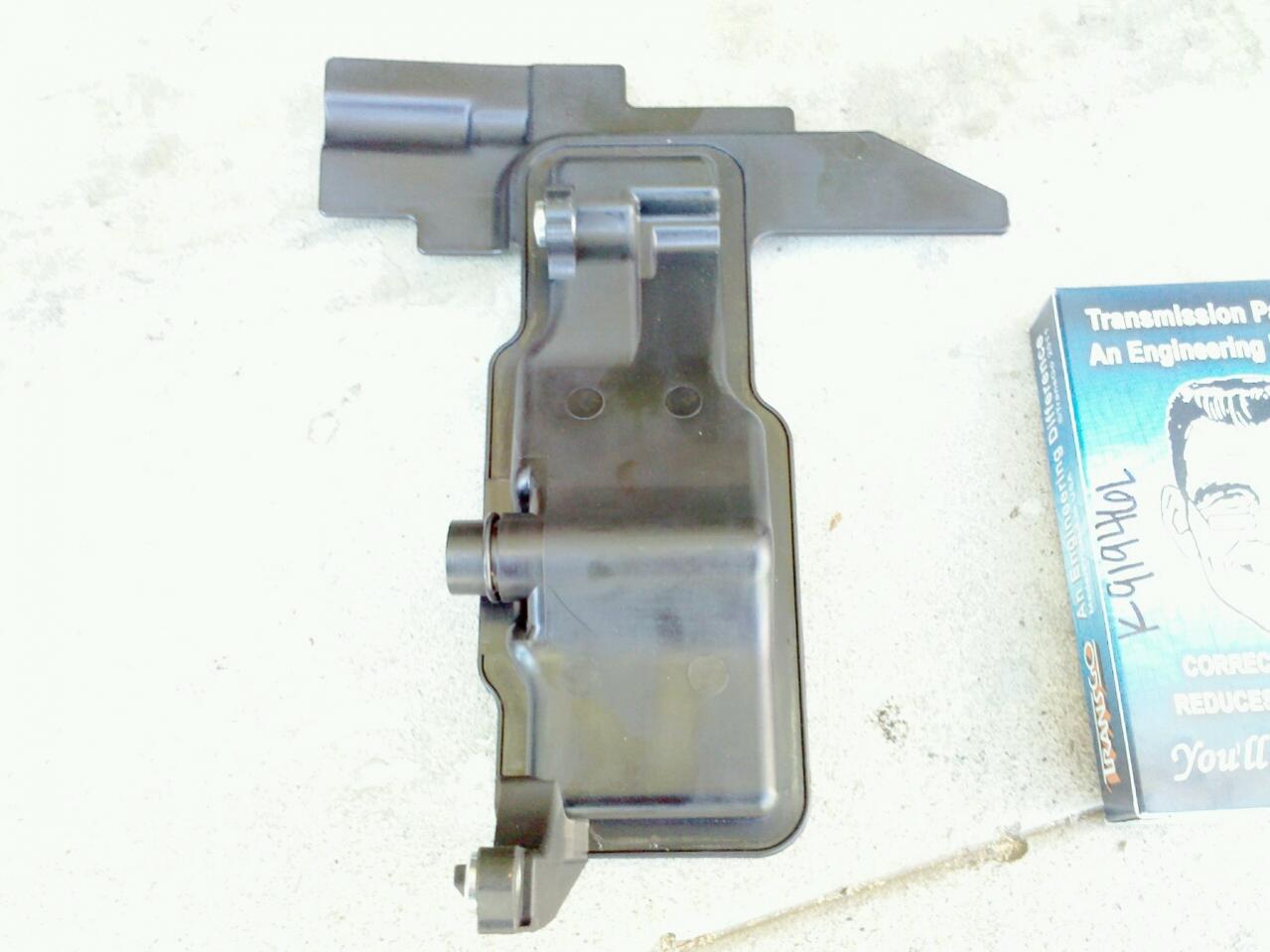

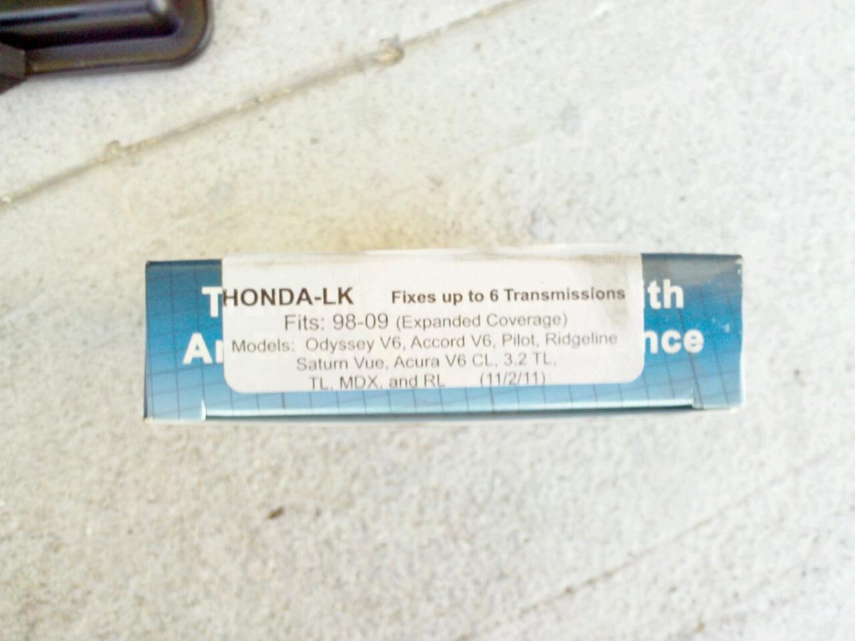

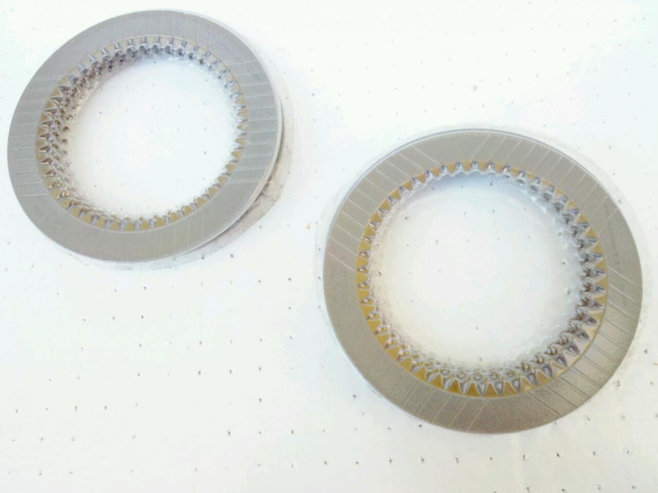

ok, so here are some things i bought for the rebuild
first i got the tranny overhaul kit for my model, then the tranny filter, and the tc control valve kit. absolutely necessary if you want to have a long lasting tranny, since the stock tc control valve is usually the culprit in burned torque converters.

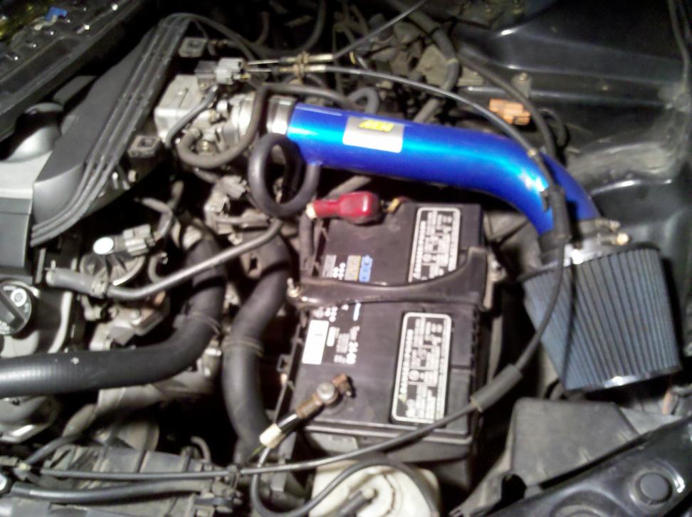

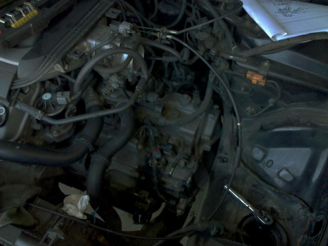

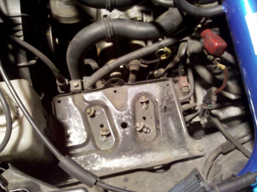

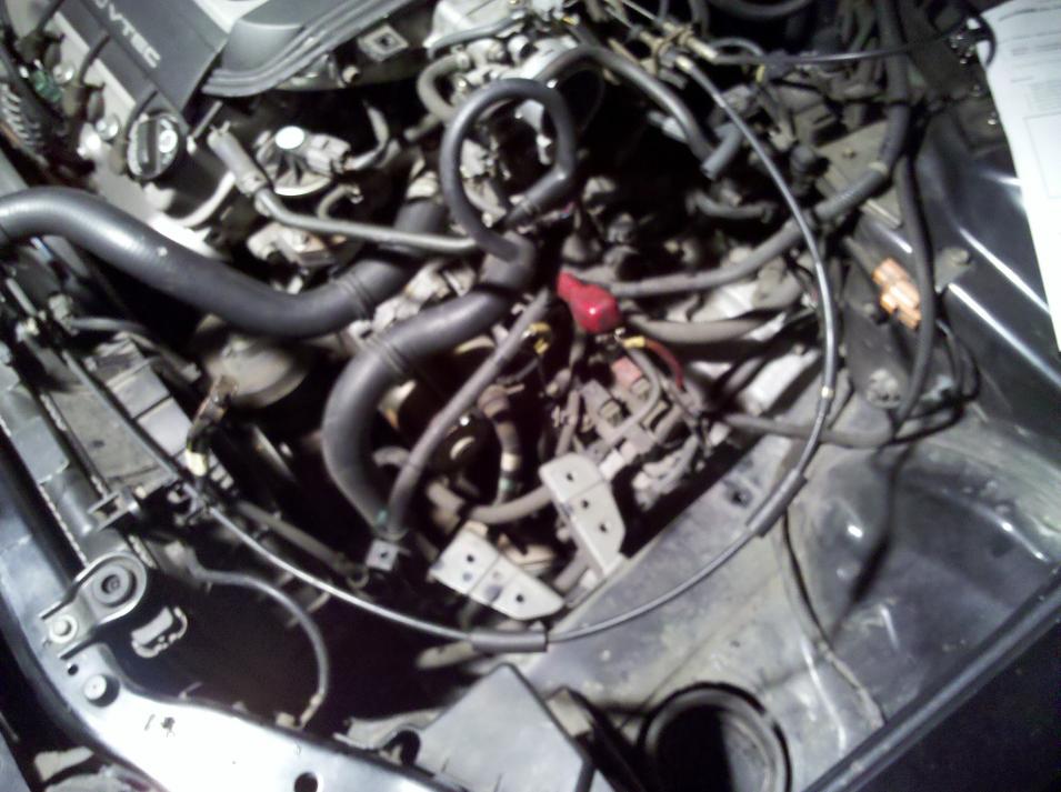

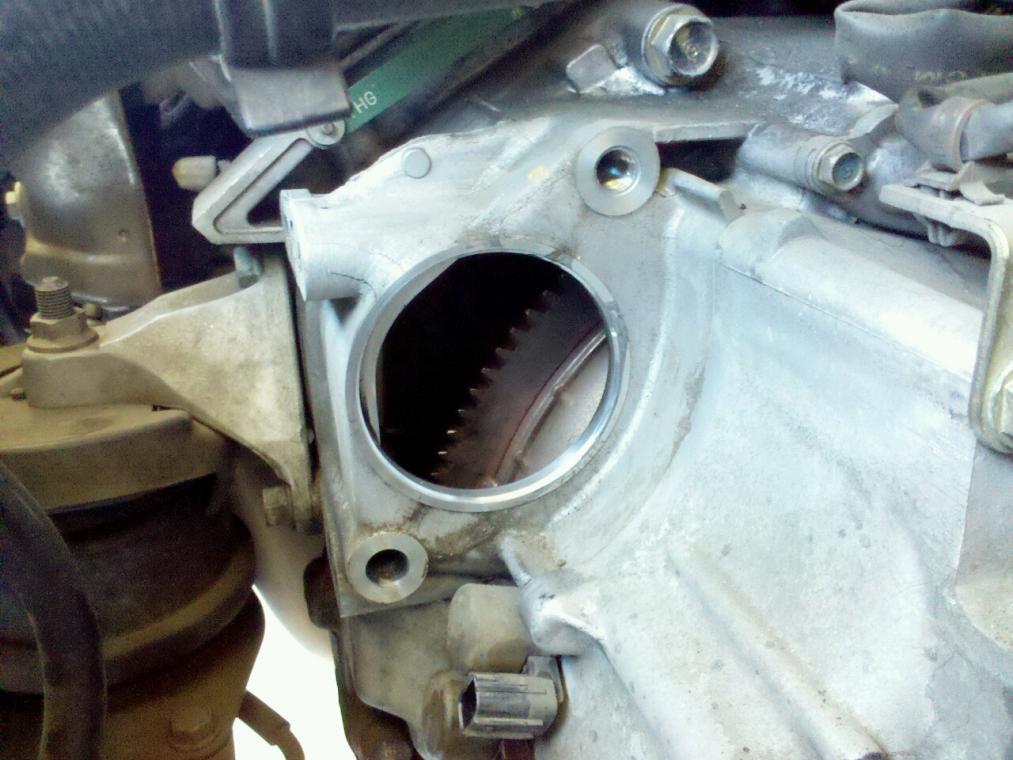

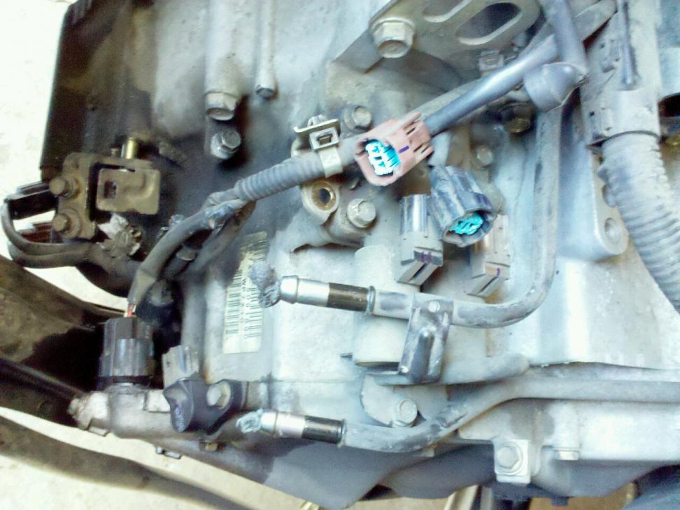

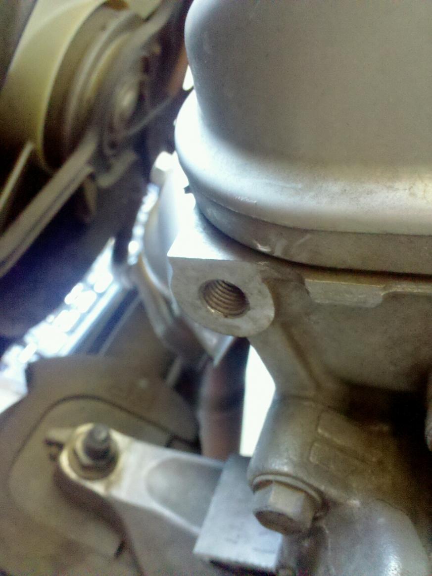

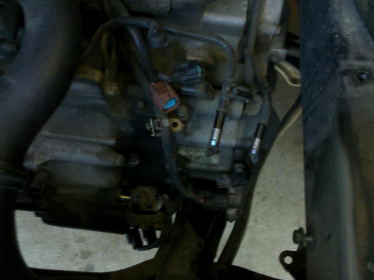

so i started taking her apart, took off the battery, battery tray, and battery tray bracket. then removed the air intake assembly, after that i tackled the starter , then this part was a little time consuming for some reason, but i finally was able to remove the wire harness cover assembly and push it back towards the car to make room for the tranny. i marked most of the connections with a sharpie, and bagged the bolts and marked the bags lol. trying not to have any FOD's lol. but now comes the improvisations...the repair procedure calls out for an engine hanger, problem is it's 500$ lol, so i got a piece of raw stock aluminum bar from work and am trying to figure out a way to fixture this so it'll work. ran into an issue, cant find the thread size call out or bolt size for the engine hanger mounts (last pic)
Attached Thumbnails Rebuilding B7XA Tranny-img_20120628_212616.jpg   Rebuilding B7XA Tranny-img_20120628_213541.jpg   Rebuilding B7XA Tranny-img_20120628_214839.jpg   Rebuilding B7XA Tranny-img_20120628_224322.jpg   Rebuilding B7XA Tranny-20120629135022.jpg
