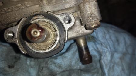

Default New Update
I still haven't been able to fix the car, but I made a discovery due to TexasHonda sugestion.
I'm sorry for the video quality, but my last two videos took half hour to upload, I'm not sure why.
I turned on the car and the RPMs were oscillating like they have been doing, and I spray Carb & Throttle body cleaner by the IAC Valve and the RPM stabilize, but they did on high RPM (1200) I wasn't sure if this happen due to the spray so I did it again, I turned off the car, waited a bit and turn it back on, the RPMs stated to oscillate again and I sprayed it again and the RPMs did stabilize once more.
If TexasHonda is correct, the problem will be an air leakage.
If you remember the O-Ring damage...
That is where it seems most of the spray went too, I did replace the O-Ring, but I am not sure if it seal since the one I bought it was a generic one.
will post results tomorrow night.
Attached Thumbnails RPM Problem Honda Accord 1999 VTEC 3.0-1-sholo20-79672-albums-1999-honda-accord-3984-picture-i-found-o-ring-gasket-damaged-after-removi.jpg   RPM Problem Honda Accord 1999 VTEC 3.0-1-sholo20-79672-albums-1999-honda-accord-3984-picture-i-found-o-ring-gasket-damaged-after-removi.jpg

Well I change the O-Ring, started the car and it keep oscillating from 1000 to 2000 RPM. I sprayed throttle body cleaner in all possible air leaks, check for damage hoses and nothing! I even sprayed the same spot as yesterday.
I have no clue what is going on.
Although I have to say that the O-Ring was flatten on both sides, meaning it seems like it was completely sealing before.
Any more ideas??
