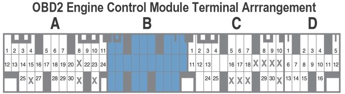

Searched obd2 pinout honda accord and found the attached image. Verify that A16 has the same wire color and you should be good.

Thank you for the diagram PAhonda, that is very helpful!

Battery should be connected. The main relay should be plugged in. You will use something like a t-pin to push into the back of the connector. Search youtube for backprobe to see what I'm talking about.

I tested and never got continuity in key II or start positions. After this test I went straight to the PCM and checked pin 16 but it looks good, no corrosion or cracks.
Do you think it could be a non-visible issue with the PCM?
Is there another test that could be done to confirm the PCM?
Could there be another component the PCM is waiting for prior to sending power to the green/black wire in the relay? Maybe a component is not grounded?

Another test you can try is to set the meter to voltage and set up the meter like you did before. You should have 12V to the blue wire (next to the grn/blk wire in your second picture) when the key is turned to the start position.
I'm leaning towards something like a bad solder joint on the PCM along Pin A16's path. You may need a magnifying glass to see it, or an app on a smart phone to magnify. It could also be an issue with a component soldered to the circuit board.
The nice thing with a 96, is you should be able to find a cheap PCM from a u-pull-it type junkyard. The PCM has to be from a 96 or 97. Is your car an automatic? Is it a LX, DX, or EX?
