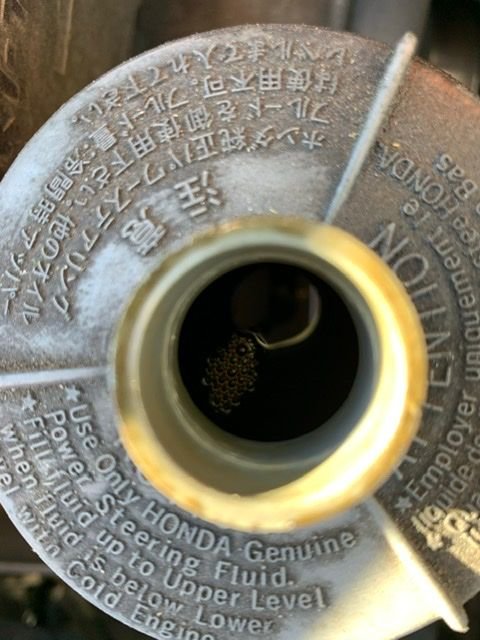

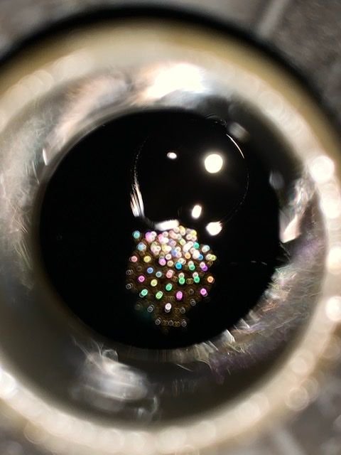

Originally Posted by PAhonda
Does the PS fluid in the reservoir look clear or foamy/filled with air bubbles?
I have attached a couple of pics that I took after driving for about 10 miles. When I checked it before I started the car it was clear, so clear that I thought it was empty, but no bubbles.
Old Mar 8, 2021 | 10:17 PM
Posts: 16,331
Are those air bubbles on top?
I believe that Accords of that era had an issue with an o-ring on the return line that would not seal and let some air into the system. It was a simple and inexpensive fix and definitely worth a shot before condemning the power steering pump. You should do a search on youtube for a video.
You will also want to inspect the belt that drives the power steering pump for signs of wear.
yes the bubbles were on the top
