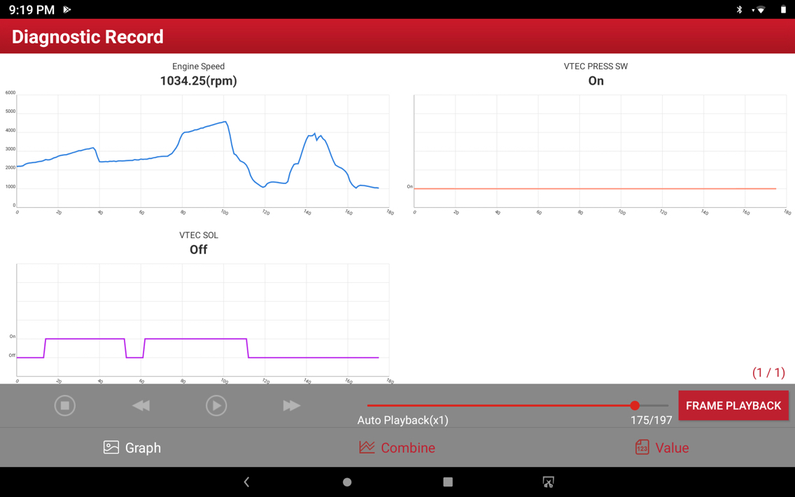

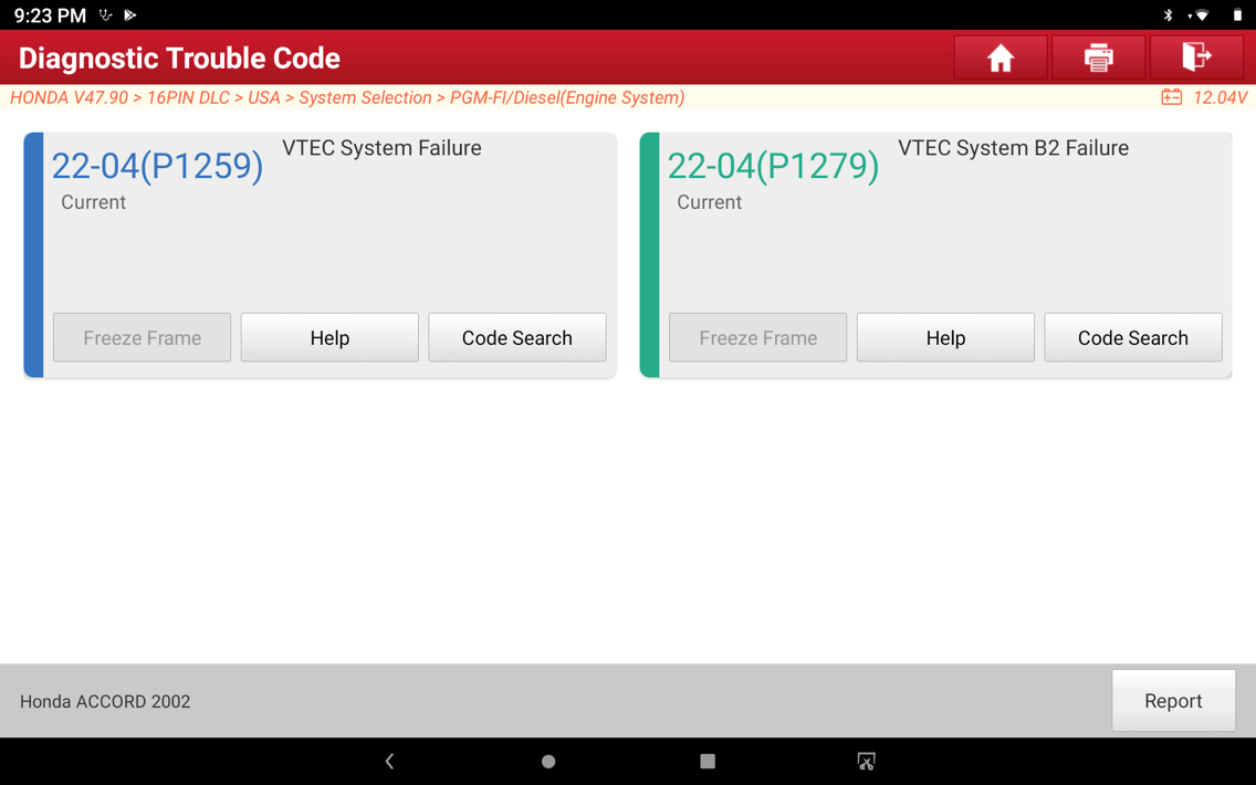

I am back with this issue again on the same car. Almost 3 months and it was working fine. I am at a lost now what to do next. It's had an oil change, new VTEC solenoid assembly, used ECM put in (both perform the same way). I'm getting voltage and that is what is so puzzling. I've attached the codes and data stream.
When I first got the car the CEL would come on instantly after it was cleared now it doesn't. The solenoid will engage a couple times then throw a the CEL. I know there is something I'm missing. If anyone has any ideas I'm all ears.
One funny thing is P1279 isn't in the code list from the 1998-2002 FSM. P1259 isn't very descriptive.
The VTEC oil-pressure switch is a kind of feedback that the spool valve is actually working. I THINK(?) that each time the PCM sends a command to the VTEC solenoid, you should see a resulting signal from the VTEC oil-pressure switch. And nothing. It looks like after 2 attempts, the PCM gives up & sets the error code.
Have you verified the wiring to the VTEC solenoid and from the VTEC oil-pressure switch is OK? The plots show that the PCM sent the signal, but maybe the solenoid isn't actually operating?
