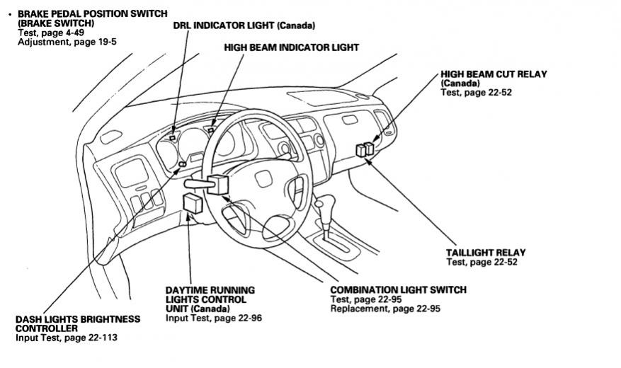

Old Apr 20, 2013 | 10:59 PM
Posts: 16,334
It will be under the driver's side of the dash, see picture for location.
It will look like the main fuel relay, but bigger. you may be able to pull out the board from the plastic housing like the MFR in this video.
