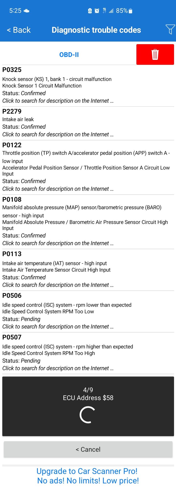

Shut it down, checked then cleared a slew of trouble codes. Restarted, now rev limit is about 4000, still rough, still high hunting idle. Seemed to **** it off even more when i turned off the ac switch....

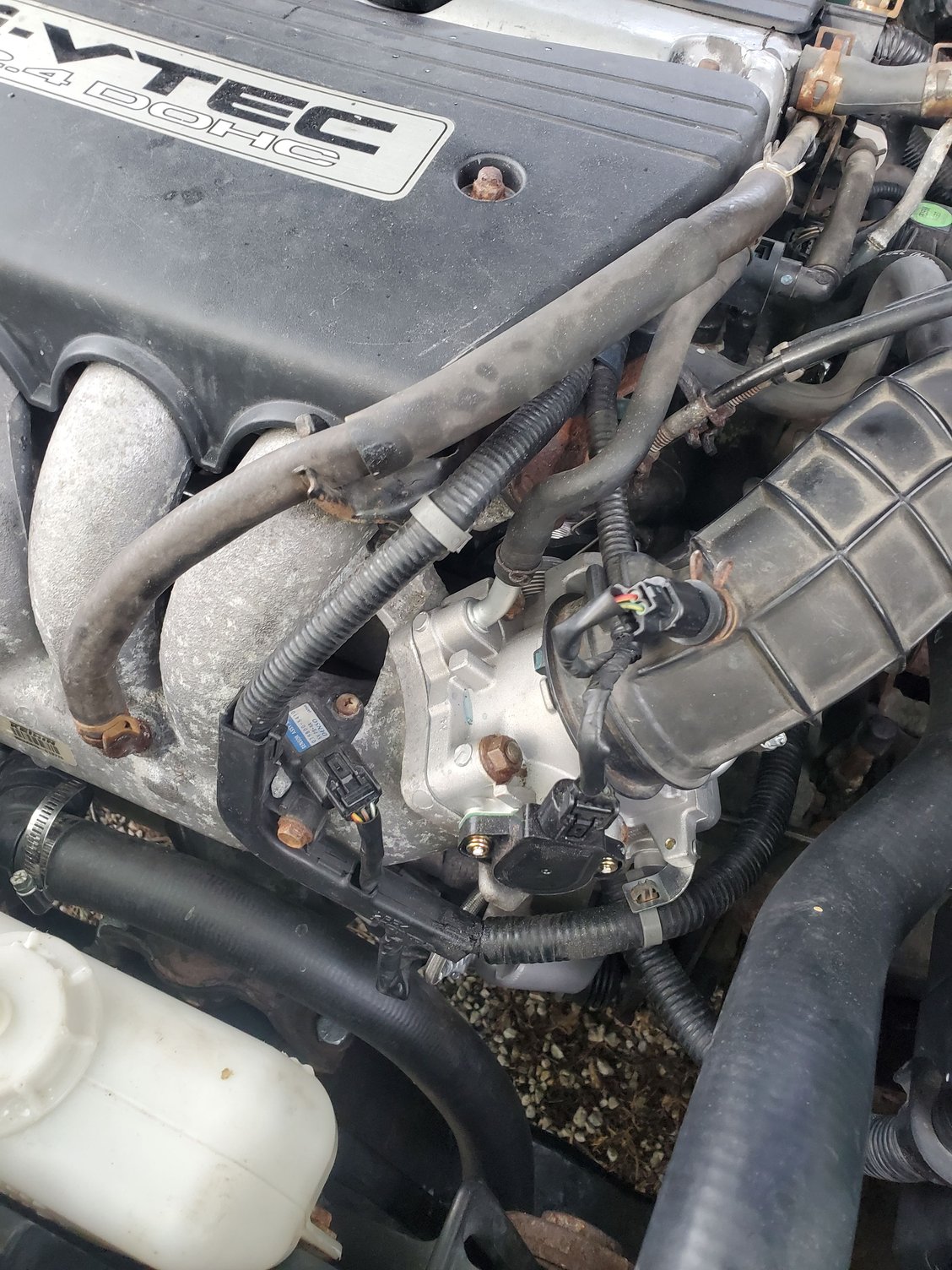

I know yall say the MAP and TPS can be swapped. I want to believe this. I want to swap them to try but its literally not possible... dunno what kind of Trying Too Hard Assclown it would take to do that by accident.

That is a lot of stuff going wrong at once. On the 94-97 accords, you could accidentally switch the MAP and TP sensor connectors and maybe on the 90-93 and 98-02 as well. Swapping the actual sensors was never possible. Your picture shows the electrical connectors aren't long enough to accientally swap.

The intake leak code has come back along with Higher than expected idle speed code

The second screen shot looks like the car is trying to find idle. Topping off with coolant might solve the idle problem.
You might want to monitor the sensors that were giving the codes to see if one of them are giving a strange input.
