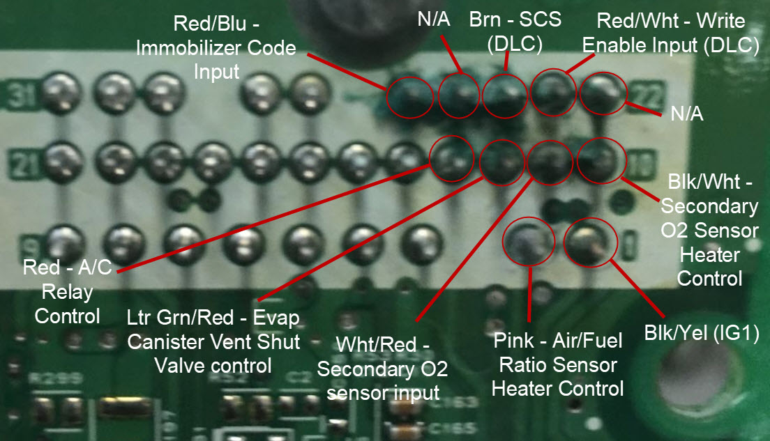

Recently, I realized since coolant leaked from the heater core, I should take a look at the ECU itself...discovered coolant pouring from around the connector pin housing. Inside smelled like coolant
and there was what looked like a blue buildup, most likely semi-dried, but where the pins are situated was dry.
On the board itself, there were no signs of short-circuitry, or intense corrosion for that matter, just a yellow substance that appears to be adhesive of some sort or early corrosion (which really doesn’t seem to be the case.) I went over the entire board with 70% isopropyl alcohol and q-tips, then allowed it to evaporate and air dry. Reconnected everything, but it’s all still the same.

All that green stuff is corrosion caused by the coolant.
It looks like the pins for the ECU wire harness got hit the worst (2nd to last picture).
If you remove the solder off the green connections and resolder, you might be able to save the PCM. I'd resolder pins 1,2, 10-13, and 22-26 (where the q-tip is at on the 2nd picture).
I can't tell how bad the pins are on the other end of the 2nd picture, but they look discolored too.
There may be other damage on the board that you can't see.

Here is some info. regarding the terminals with corrosion of ECM/PCM Connector E. The Service Check Input (SCS) from the Data Link Connector (DLC; aka OBD port), Write Enable Input from the DLC, and the Immobilzer Code Input terminals are part of those.
Attached Thumbnails 03 Accord EX 2.4 5MT mmobilizer issue derailed-crank no start.-connector-e-terminals.jpg
