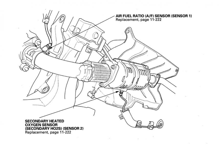

When I search for a/f ratio sensors, all I'm coming up with O2 sensors. Is that the place to look for? If not, where's the a/f ratio sensor located?
Old May 22, 2014 | 11:29 AM
An air/fuel ratio sensor is a wide band type of oxygen sensor. See attached image for location of sensors.

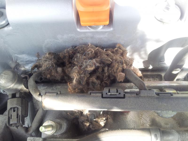

I did notice something however a few things however. The heat shield surrounding it was really rusty, to the point of crumbling when I touched it, and when I checked the fuel injectors, I came across this pretty site. I *think* it's from the cloth insulation from under the hood, as I noticed it was sagging quite a bit.
Highly doubtful, but do you think debris from that stuff could trip the code as well?

I doubt the debris is the cause of the trouble code you currently have.
Old May 25, 2014 | 06:20 AM
That looks like "something" was trying to make a home under there?
