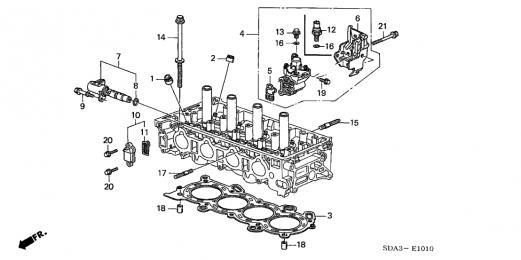

Old Nov 4, 2013 | 04:13 PM
Default 03 EX VCT Screen Location
How about #5 here. It's very much like the VTEC spool valves on earlier engines. I'd get a new one because the screen in incorporated into the O-ring-type gasket and the old one is probably hardened with age & heat.

I disconnected the negative battery terminal for an hour to reset the ecu, but the problem remains. The car barely idles now, and stalls after a few seconds. It probably wont make it back to autozone to recheck. Could the code p0341 mean a timing chain issue?

Jim, I have no clue where this is or how to change it or what I need! Could you be a little more precise? Thanks.
Old Nov 4, 2013 | 04:41 PM
Posts: 7,101
P0011 is Variable Valve Timing Control (VTC) System Malfunction.
The VTC strainer is part #11 in the parts diagram.
To access it, you need to remove the drive belt, then the power steering pump, and then the drive belt auto-tensioner. I also attached an actual picture showing the location.
After that strainer is cleaned or replaced, you would change the engine oil and oil filter and recheck for the trouble code.
Attached Thumbnails 03 EX VTC Screen Location-vtc-strainer.jpg   03 EX VTC Screen Location-vtc-oil-control-valve-l4-465435.jpg
