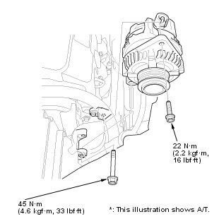

I'm trying to understand which bolt you're referring to.
On the V6, there are two mounting bolts, with the smaller size mounting bolt at the top. Are you referring to the top bolt like this image?

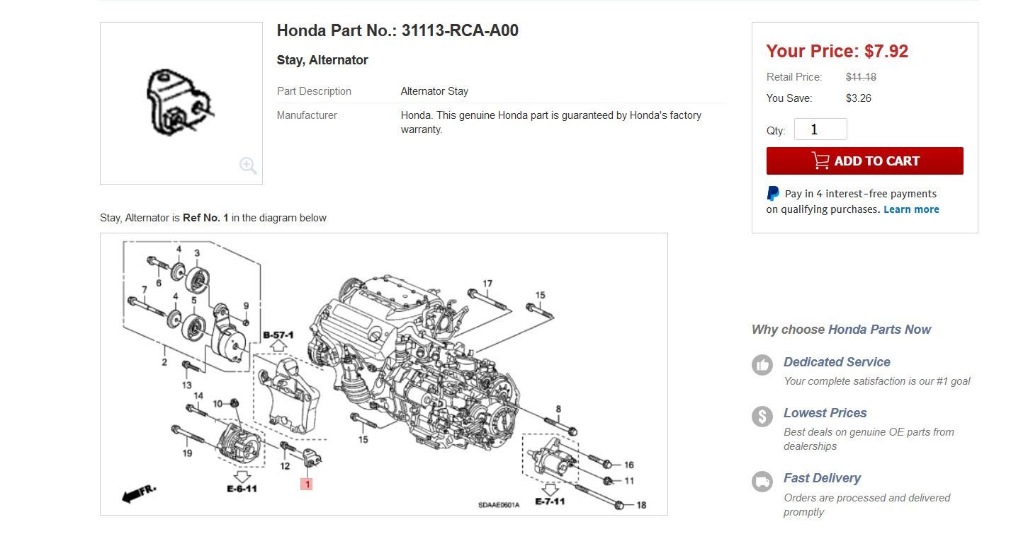

Old Mar 26, 2021 | 11:30 PM
If you're referring to the top mounting bolt like in the image I previously posted, it is mounted onto an alternator stay which can be replaced.
