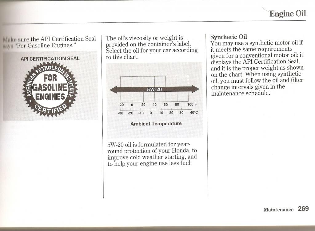

The last sentence. Or you can always choose to ignore this advise, but check your oil level every time you fill up with gas.
Attached Thumbnails 09 Accord - Oil Change/Filter Advice-scan0009.jpg
