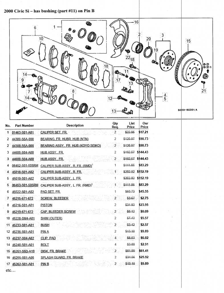

Studying this more... I found a great diagram that matches this for a 2000 Civic SI.
I also found this part which is not on the '11 diagram list of parts is a 'bush' or bushing.
It is placed on top of the caliper position to minimize vibration - that's it's purpose.
I also saw a picture - it shows one of the pins with a cut down detent for this bush to slide into at the end of the caliper slide pin.
I only noticed clean contours on both pins, so it was likely always there just smeared in lube grease so I didn't notice it was a rubber part at the end there.
Still, I will go verify it now, and that the pin with bush at the end is in the upper position of the caliper slide bracket.
Attached Thumbnails '11 rear brake broke - caliper not frozen, outer new pad shot to metal - why?-hondavsacura-2000civicsi-caliper-diagram.jpg

I never had a 2011 so my information is kinda general from a few other Hondas...
That "bushing" on the end of the slide pin is rubber and it fits just like you described. It had occurred to me that if it popped off of the slide pin then it would prevent the slide pin from going far-enough into the hole; & that in turn would cause the outboard pad to drag.
