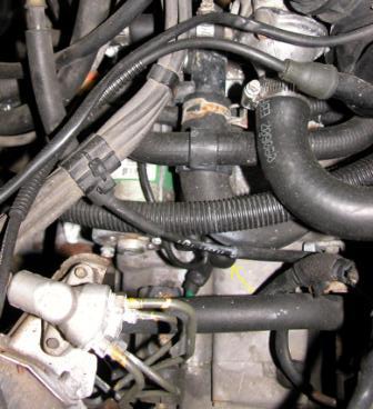

Sorry, thought I had a pic.
Anyway, try this. Tell him to stand right by the pass side tire and look towards the drivers side tire. The starter is under a bit of "piping and that"....or tell him to follow the positive cable from the battery, yes it splits. One side goes to the under hood fuse panel, the other goes to the starter.
EDIT: I did have something. I know it looks bad...but you see the :green: that is the starter,-left center of the pic- on the DX - Carb'd vs this LXi things are a bit dif but the same

Thanks Poorman, will give it a try. Hope it's not too complicated for him- he's a graphic design major....
