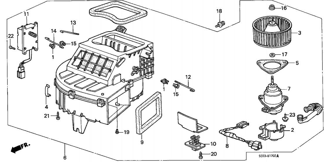

It looks to me if you remove the motor at it's own triangle flange, then the blower (squirrel-cage) is too big to fit down through the opening. Do you have to undo the clips (#4) and open up the whole box?
I never owned a 1989, so I hope Poorman212 chimes in. He likes those cars.

yes thats the motor but to remove it you have to remove it sqirrel cage and all
you will see the motor bottom which is about 3" in circumference hanging down but it is part of a mounting plate that is about 7" in circumference almost round and held in by 3 screws
after you remove the 3 screws it will kinda drop down but you have to turn it a bit to get it out of the hole in the blower case
the best way to understand would be to get a new part and you will see excatly what it looks like
and its not a waste because you now know thats what the problem is

Let me see if I can type it out. Thru the Rec door you can get to the nut that hold the cage to the motor. The trick-killer part of this- is getting the nut started back on the new motor.
Old Jan 20, 2013 | 05:52 PM
So... to get the motor out, do you first have to undo that nut & remove the squirrel-cage from the motor shaft?
