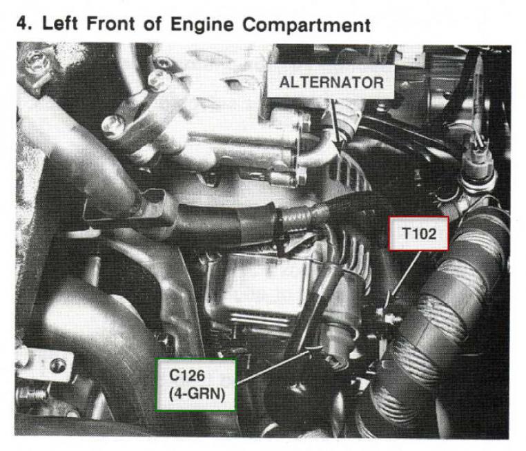

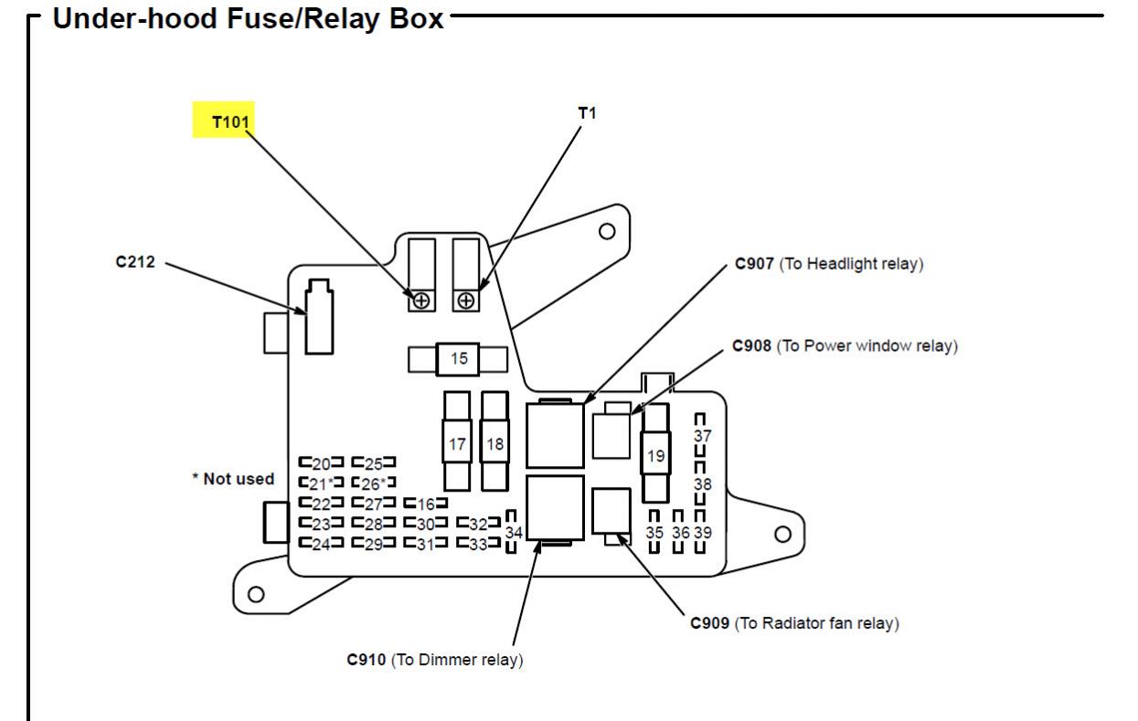

If you're still having an issue, get yourself a multimeter or voltmeter and do some testing.
1. At the alternator's green connector plug, disconnect the plug. Then test if there is voltage (battery power ~ 12 volts) at the Blk/Yel wire with the ignition switch in RUN or START.
The Blk/Yel wire supplies the ignition input that turns on the alternator/regulator assembly. If there is no, low, or intermittent voltage coming through the Blk/Yel wire to the alternator, the alternator will not charge or have problems charging.
2. If there is ~ 12 volt at the Blk/Yel wire from the first test, then test the voltage at the alternator output cable (Wht/Red cable) at the under-hood fuse box (T101). This alternator cable supplies current to the battery. (Wht/Red is a cable with white colored insulation and a red stripe running through it.)
You can also check the connector (T102) at the alternator, to see if it is the same reading as at T101.
Check the voltage with it idling, then raise the engine speed to 2,000 rpm and hold it there, and see if the voltage increases.

Yes, voltmeter's red lead to the wires I mentioned, and black lead to body ground. Be extra careful of moving parts when checking the alternator with the car running.
