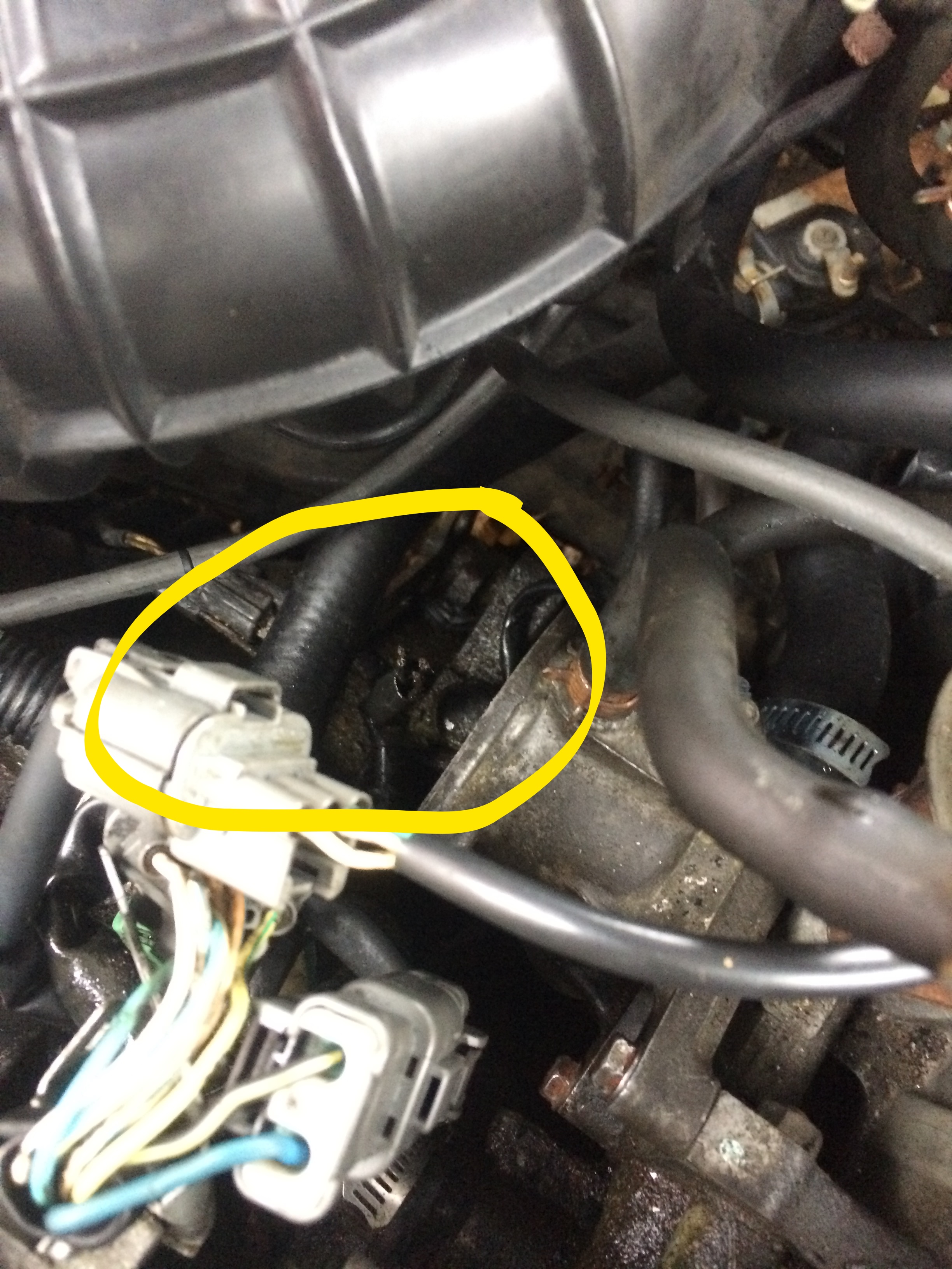

Would this cause my car not to start? This water outlet/thermostat housing wiring snapped, would this cause my Honda not to start? What is this component and whats the name of this part?

That is one of the many ground connections for the wiring. That is the most important grounds, because it grounds the engine/transmission computer (among other items) and is called G101.
You'd need to replace the entire wire harness to replace that part. All you need is an eyelet (or a few) big enough for the the bolt to go through. You'd have to attach them to the end of the broken ground wires.

So to understand, So the part I need is a wiring harness? Is there a specific naming for this harness and G101 would cause a no start im assuming being it's a ground connection. This may be the culprit. It cranks but NO start.!! Is this a DIY job, I believe with wiring I am able to do it.

you need a new connector to the end of the broken ground wire,,

Just repair the wiring harness and attach the wires that are broken to that ground. You should be able to attach an eyelet to the broken wires and bolt them down.
Replacing the entire harness would take a ton of time and be expensive.
