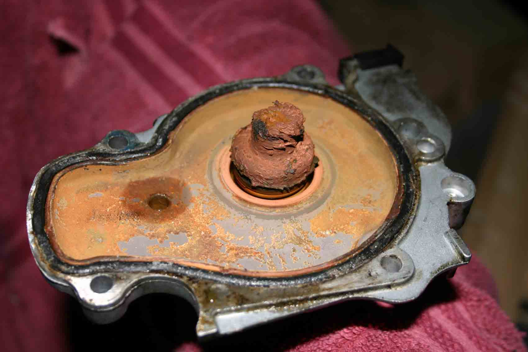

Problem solved. After all that it turned out to be the H2O pump. See picture. That is what happens in 9 months running straight H2o instead of 50/50. I learned my lesson.
All is good now and i have 50/50 in the radiator and everything has been flushed.

Glad you let us know what you found. I live in Michigan and with our winters no one can run water so we don’t see failures like that.

Of the few cooling systems that I have seen turn to rust like that they did return to rust again even after a flush. . Over the years I have seen additives to prevent that thro.
