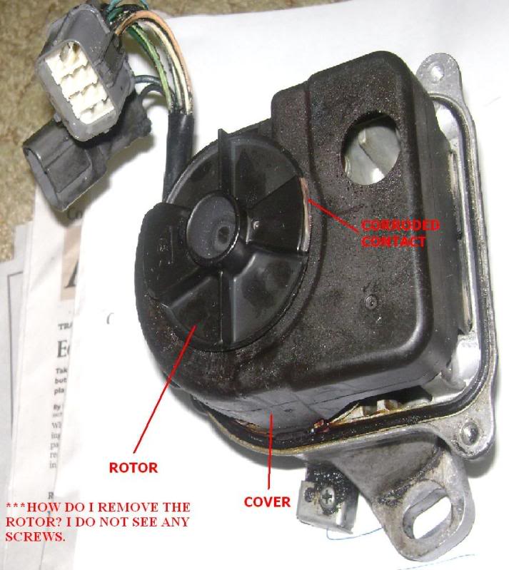

I am attaching the picture of the distributor I pulled out. I would like to go inside and see what is the condition of the ICM, or may be replace the ICM if I go that route. How do I remove the rotor form the assembly. Some sites mention that it is attached with one screw. I couldn't see any screws at all. Even if I buy a rebuilt dist I still have to salvage the cover to use it on the new one and have to install a new rotor. When I manually rotate the shaft, it doesn't seem to turn smoothly like a shaft with some good bearings or bushing. There is a little bumpy feel as you turn the shaft. Any help on this will be greatly appreciated.

That black cover is going to have to come off. Then there should be one screw holding the rotor to the shaft. I don't know how that cover comes off.
I don't know what you will find by looking at the ICM. It is a sealed unit. You may want to clean up the connections. It should be under that cover too.
