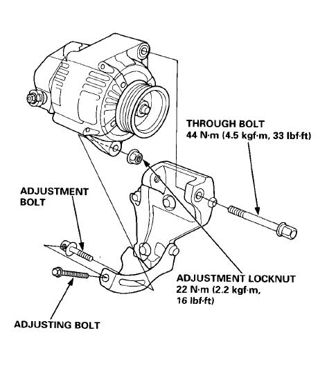

If you backed the tensioner bolt all the way out and removed, you left the tensioner lock nut holding the threaded adjustment part the tensioner bolt threads through. This would leave the alternator locked to the adjustment bracket. This lock nut is difficult to see and access and has caused problems for many.

Title says 93, yet it starts off as a 94. See if this pic for a 5th gen (94-97) helps. If all of the bolts and nuts are out and it still won't move, try some gentle prying, push on the belt, ect. After many years these can get a bit tight.

I put a large flathead screwdriver here and pry it off

MY BAD, its a 1993 and i got it out, just went back to the car moved the powersteering pump and etc crap on the side. Cut the belt, there was a bolt underneeth the alternator i dunoo what its called but yea got it out. Worst part is, took it to autozone got it tested and they said it works fine, yet the car had a battery light come on the dash when the battery was brand new it died got it recharged o'rileys put it on the car still battery light is on.
