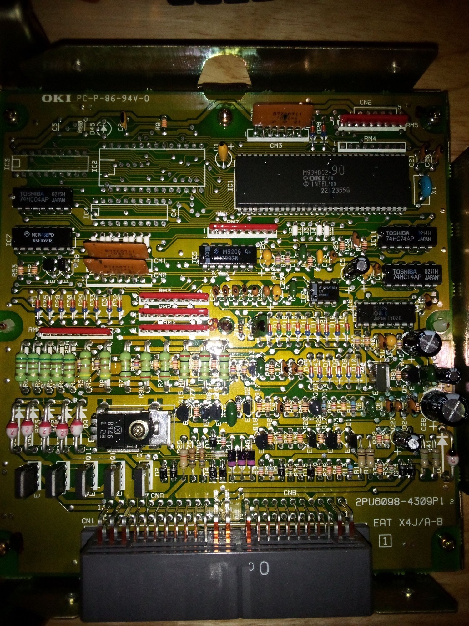

Now the TCU I'm going to show you (in a picture) isn't the one currently in the car. Which is allegedly causing the D4 light to blink. This TCU is the one that is allegedly causing the D4 solid light (in the picture). This was not repaired. The one that is currently in the car was sent out for a repair on Nov 3, 2021. So some where around in November 2021 I had the original TCU repaired and fixed which did not fix the issue. The TCU that is currently in the car could be damaged. Which I haven't had to a chance to taken out of the car. So maybe the Shift solenoid did damage to the TCU. But even before I installed the shift solenoid. That fixed TCU didn't repair the problem. Anyways, look at this current TCU and see if you can find an issue with it. I cannot.

Update. There was a change. I took out my original TCU, The one I have been using. And yep there is a bad transistor, And you can even see a leak under it.
So now I decided to swap the one that I showed in the picture in this thread, the one that I never repaired. I put it in there. I turn the key. And the P and D light up. D lights up for 3 seconds and goes away. I put it in D4 and yes there is no longer a blinking D4. I stop the car, and accelerate, I don't see much difference. I stop the car and put it in P. And the D4 light has not stayed solid. When I pull the in the drive way, It still needed acceleration. I thought that was unusual, because if it isn't in it's solid D4 solid state it wont do that. You can just not press the gas pedal and it will go up a slight incline.
So anyways, I went to check to see if the Code 7 is still there. Nope. Now we got a new code. It's code 15-Kick down switch circuit shorted. So I was correct that it was the TCU that was causing the blinking D4 light and if I swapped with the other one I would get the D4 solid again. But D4 solid comes maybe after 3 to 4 days or after resting the computer. So it will come again. The only thing I was incorrect was the slight barely noticeable acceleration after stop and slight incline. That usually only appears when D4 solid appears. And the new Code 15. I did a little research and it appears Code 15 could be a sign of a bad TCU. And of course I never got the TCU repaired for one that is in there right now.
And you know what looking at the original TCU helped me compare it to the one that's pictured in this thread. I can clearly see leaks near RM1 near the middle, towards the right.
I guess at this point. I will go ahead and order a used TCU. Possibly a refurbished TCU. And cross my fingers.

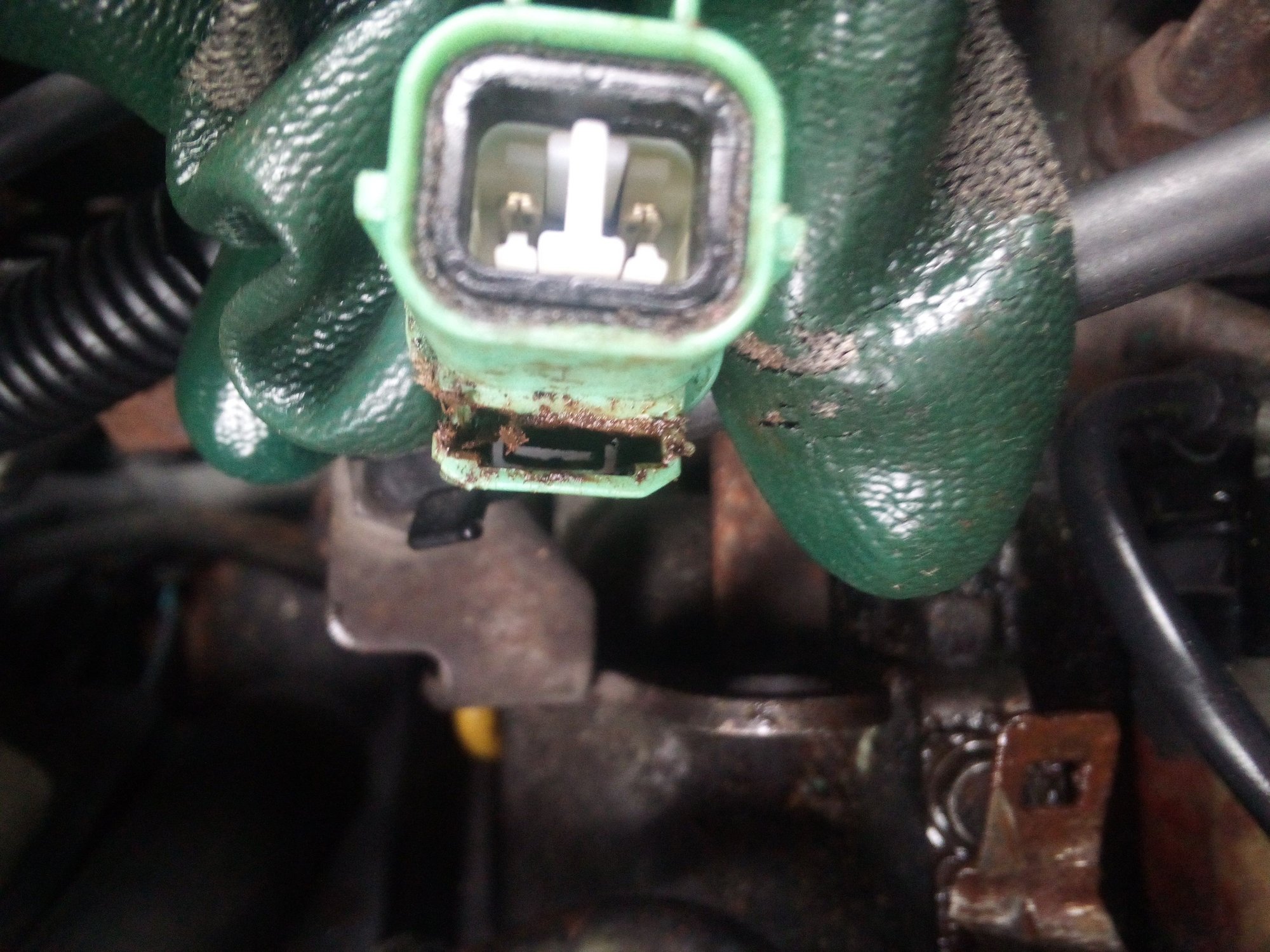

Okay I finally got at those sensors. The Mainshaft Speed Sensor (NM) TCU code 15. I will kind of give any info that I got just because I couldn't really find this information on the internet.
You take the front right tire off. Once you got this tire off. You will see the transmission. It's literally right there! The sensor and the bolt that holds it on. You don't have to worry about this bolt breaking off. Or spray WD40 on this bolt. It's in the transmission and its clean. Just use a 12 point 10 mm wrench. You wont have enough space to use a standard socket.
10 mm, 12 point wrench to remove. Mainshaft Speed Sensor NM. Take the front right tire off.
Next after you get the bolt off. You want to just twist the sensor left and right. Back and forth. And eventually it will come out. Once the sensor is out, you will notice there is a O-ring on it. Check to see if it's good. Okay after that, you open up the hood of the car. And you might have to take the air cabin filter off. It's really easy. You might not, I had to take mine off to look for the NM sensor since I didn't have a proper guide on the internet. I had too many false leads on where to find it. But, anyways you follow that short wiring from the speed sensor. Up to the point where you find its power connector from the wiring harness. This is where I got into some trouble.
My sensor was stuck on a metal bracket that holds that connection in place. There is a small slot on the sensor that goes into this metal piece on the car. If it's stuck on there, it's nearly impossible to unplug that power connector. I tried WD40. I tried putting a c-clamp on the little notch. That clip that you are suppose to press down. So you can disconnect it. Nothing will work if it's rusted in there. I tried using a flat head to see if I kind of loosen it and wiggle it out. Nothing, it wouldn't budge.
So finally what I did was. I decided to cut that plastic slot that holds that metal bracket in. It's not a ground or anything for the wires. You wont be cutting the wires or actually breaking the speed sensors connection in itself. I'll show a picture. I should have done a better job of it. You don't need to break the whole entire thing. You just need to use a small cutting tool. Just to free up one side. My dremel cutting wheel wasn't working good. I just took a small cutting tool from a pocket knife.
I disconnected the Countershaft Speed Sensor (NC) power connector. The NC Speed Sensor is also there under the tire. It's just towards the right. I didn't bother taking it off. You can see it from the top if you remove the car battery and the car battery's plastic bottom piece. I had to do the same with this connector as well.

Have you taken a picture of your TCU uncovered?
Something is even happening even more weird in my case. My original TCU that has a damaged transistor is working better than the other TCUs. It's kind of really scary. Because I wonder if I rehook that original TCU up. It would no longer go more than 20mph. Because then I'm really screwed. The original TCU that is malfunctioning works better than the other TCUs. Perhaps that TCU is ignoring something with the sensors. That the other TCUs are not. I just can't remember what it was, I thought I remember someone telling me they actually unhooked one of their sensors to troubleshoot a problem.
Alright, after this I decided to test the ohms on the Mainshaft Speed Sensor NM. I plugged the black probe into the com port. I plugged the red probe into the VmA port. I set the multimeter to 2k. The ohms dialogue. The horseshoe symbol. I got 480 ohms. Which appears to be in range. Next I wanted to test the ground to short on the power connector that hooks up to the mainshaft speed sensor. Believe it or not it took me a while to figure this out. All you had to do was hook up the car battery. And you have to turn the key to the start position or it wont send out volt signals. I had finally figured it out when I watched a youtube video of someone testing out another speed sensor. I also unhooked the NC speed sensor, the shift solenoid sensor as well. With the digital meter. You set it to DC voltage to 20. The probes stay in the same ports. You want to put the red probe into the lead of the power connector and you put the black probe into the other lead of the power connector. If you get a negative voltage, Then switch the probes around, you will find the ground wire. OH by the way I did reconnect the TCU. I don't know if it still sends voltage with that TCU disconnected. I also heard a strange buzzing sound coming out from the hood of the car.
Anyways, I got 0.28 voltage on the Mainshaft Speed Sensor NM and I got 0.28 voltage on the Countershaft Speed Sensor (NC). And I got 3.72 voltage on the shift solenoid. So I'm assuming maybe the mainshaft speed sensor code 15 is good? And the power connector is good? Maybe it was the dirt build up on top of the sensor. That could be. That troubleshooting guide indicates if it has metal dusting on it, it wont work properly. Anyways I ordered another a mainshaft speed sensor just in case. I will wait to hook it up and see if the TCU code 15 goes away.
